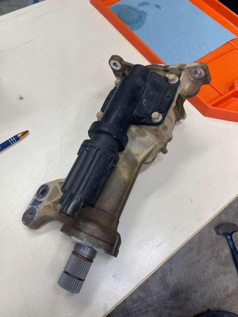

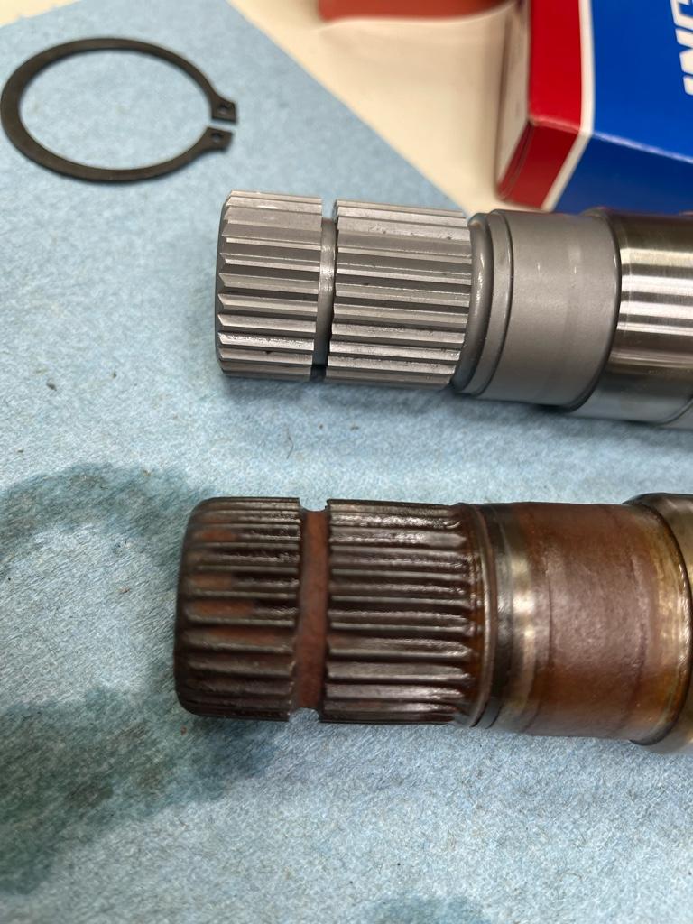

For anyone with a DS or DT Ram. I was having a pretty bad vibration caused by the splined connection to the front CV shafts being rusted out

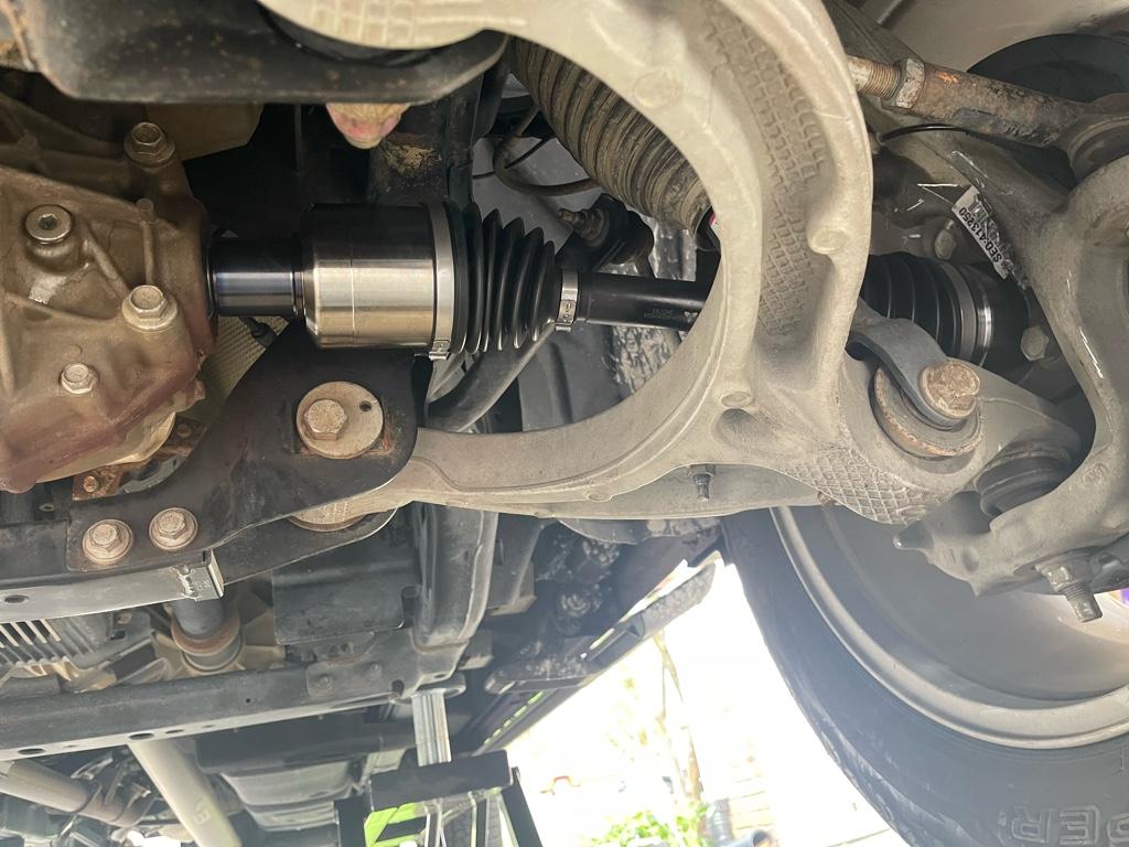

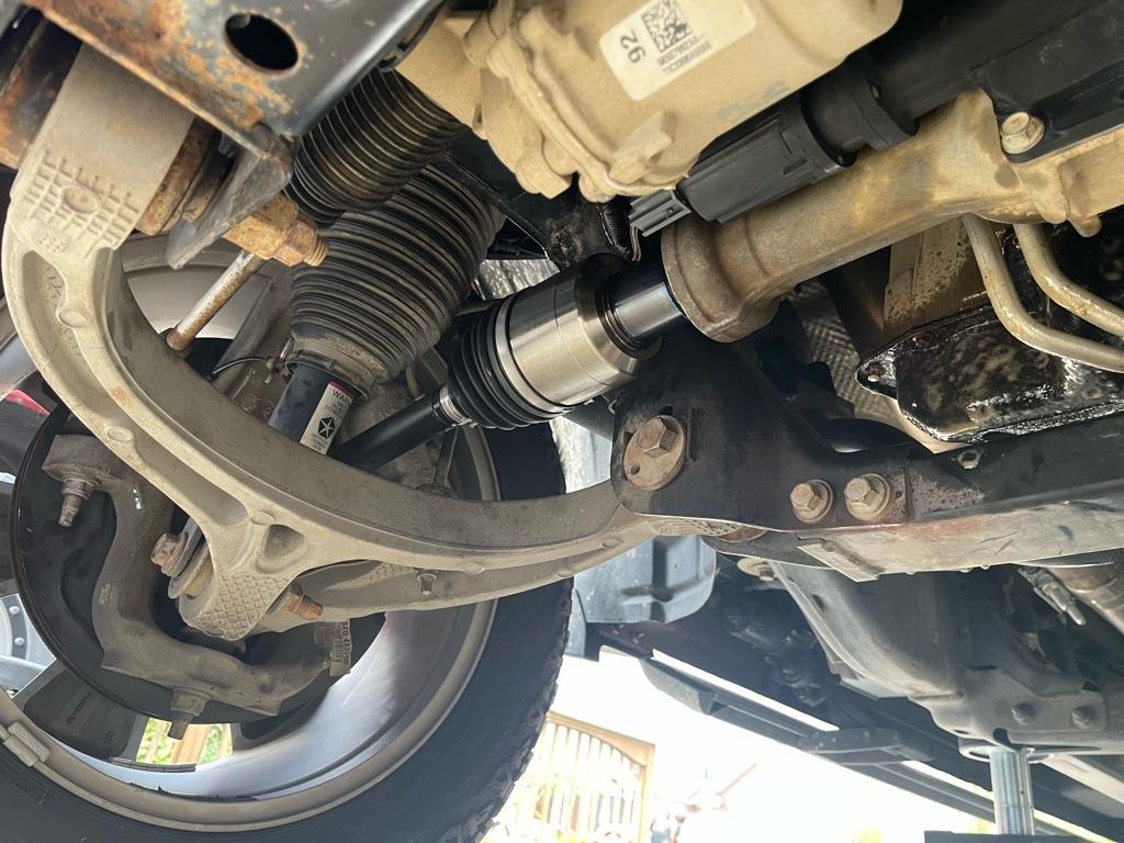

. I experienced this on my 2014, and now on my 2021. I bought a kit off Amazon that included new CV shafts as well as new output shafts, bearings and seals. I finished up installing it today, and the truck is smooth as butter again.
The hardest part was getting to the last bolt to split the housing. Had a buddy with a shop press to assemble the bearings. Very nice kit, well worth the money!
