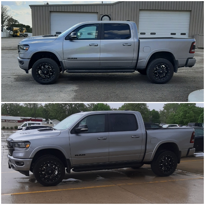

Finally got the orp springs installed. Top is mopar 2" lift with front orp springs. Bottom was just the Mopar 2" alone. From center of wheel straight up to fender on both fronts is 25 1/4, both rears are 26 1/4. Exactly 1 inch of rake now and they did exactly what I wanted. Honestly I can't even tell a difference in the ride, in fact if anything I thought it felt a little better. Really happy with it overall. Keep mind I have never drove my truck with stock suspension and factory tires. I got in it at the dealership with the Mopar lift, and E rated tires.

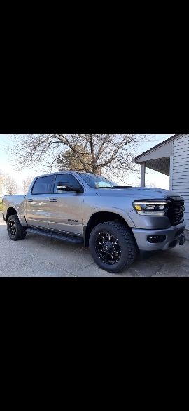

Can you post a few more pics when you have some free time? Looks great, what tires and size are you running?
Nitto terra g2
305/55r20
Fuel Krank wheels +1
Don't have a lot of pics. This one is before adding the orp springs. Shows the wheels and tires a bit better.
