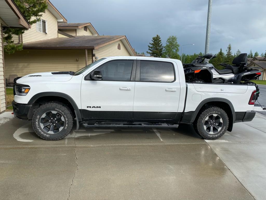

I’ve had my CFMoto 600 2-up in my Rebel with RamBoxes. It seemed to do well. As you can see I need to put some airbags in the springs to prevent sagging.
