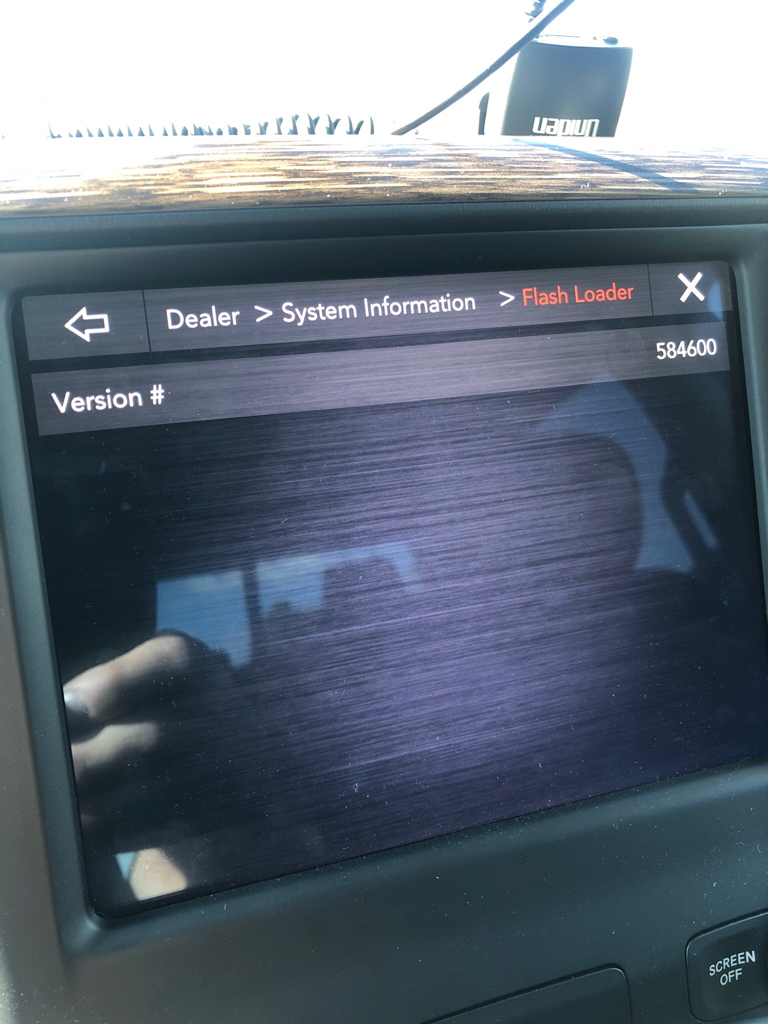

My truck was at the dealer for a laundry list of stuff for this week. It’s an early build (April 2018) so it has a ton of open TSB’s. One of the items was how the ventilated seats on the drivers side showed on the Uconnect screen. It was a really obscure issue that requires that the dealer open a STAR case. After two days of trying different updates with no resolution, FCA sent them a new one which fixed the problem. This morning when I got to work I thought “let me try getting into dealer mode now” and I held the bottom left and right corners of the screen and it worked!!! I guess the original software didn’t allow this, but now it does so I can see HW and SW versions. Radio also sounds a lot better and car play connection is much faster.
