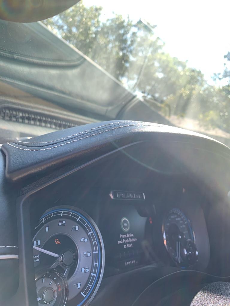

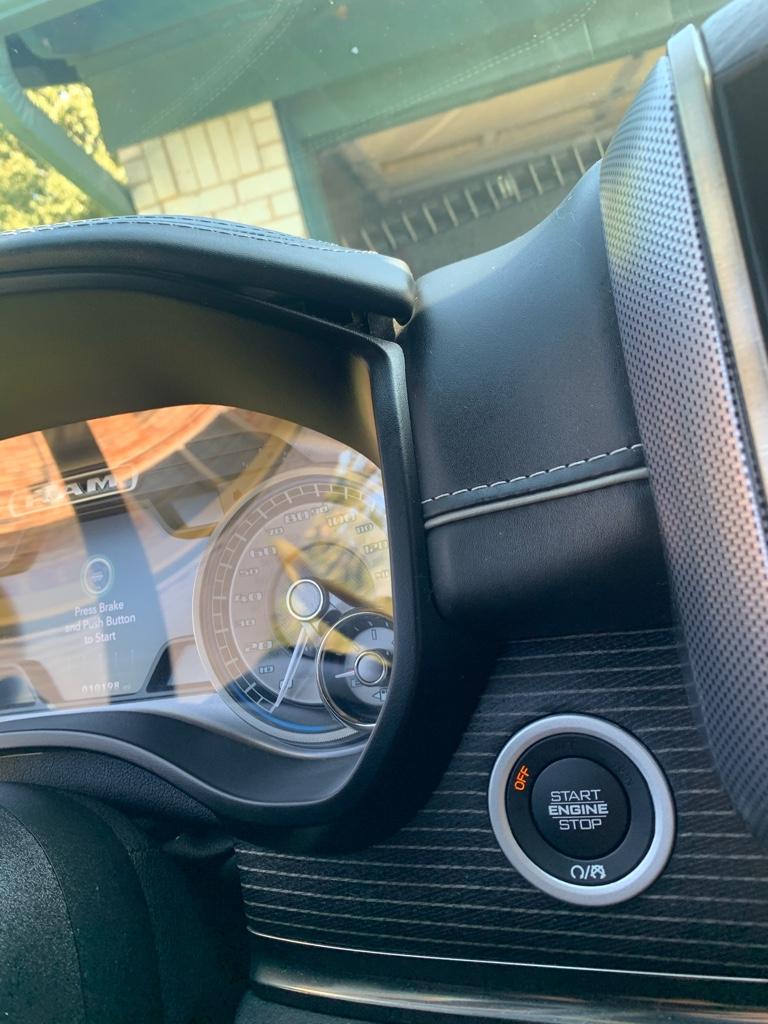

Apparently they changed the design on these for 2021. Or maybe it's just for those with the HUD. But the hood over my gauge cluster is not removable. I'll add a pic later today after I get home from work. I had a discussion about this with the sales rep when we went on a test drive and I noticed it's different than my wife's 2020 Limited.
Edit: Added pics
