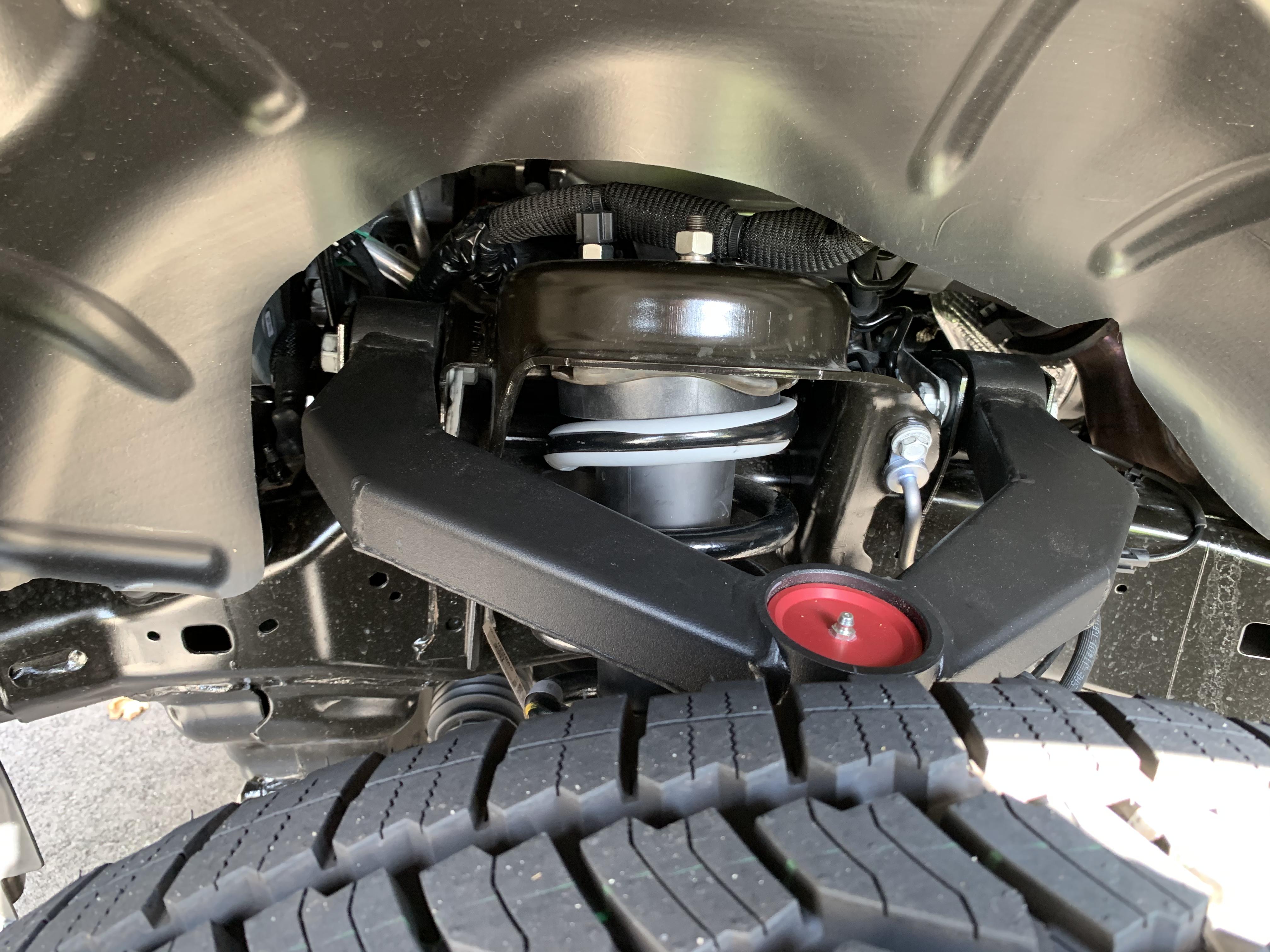

Zone UCA’s also work despite their website. I contacted them directly and they stated they do fit the 2019-20 new body style.
Here is my BTS with Zone UCA’s and a Motofab 2” spacer with the ORP

If you are keeping factory wheels and depending on the size of tire (I.e 35s) I would go with the Mopar ones in the 2 inch lift. Other aftermarket UCAs are better but recommend less of an offset on the wheels with 35 inch tires if you don’t want any rubbing. You could use wheel spacers but I just went through this and it was recommended I definitely use the Mopar UCAs before using wheel spacers off road since I didn’t want to buy new wheels. If money is not an issue and you are open to buying new wheels as well, then the zone’s (shown above) and fabtech’s (designed for 3 inch lift) would be on my short list. I am not an expert, some people on this forum are, this is just one man’s recent experience.

With the ORP and 2” motofab I’m at 3”. Only reason I used the Zone UCA’s is that I had them already new sitting in the box. I never put them on my 4th Gen.
But your right I’m keeping the stock wheels and the tires are pretty close to the UCA’s already. Gonna probably go with a 275/65/20 to play it safe.
