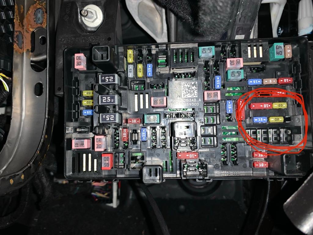

I have an ozone generator for my 2019 rebel mainly for hunting purposes. It runs off the 12v outlet. It will not kill the battery even running overnight (at least on my ford it didnt).
I can find how to make the 12v always on in a 2018 (stupid simple) But there is nothing on the 2019 and this needs to run while I am not in the vehicle for maximum effect.
and help?
Ps 1st post! So hi how is everyone!
Very easy to do
Need to move a fuse
The bottom right yellow. This is the always-on position. Yours would be more to the rightth. Pull it and put it back in just like this pic
(At least i think it was always on when I took this pic)
Very easy to do
Need to move a fuse
You're right. Did that in my 2019 Laramie.

Move the fuse over one post 😁
