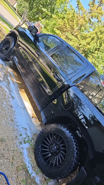

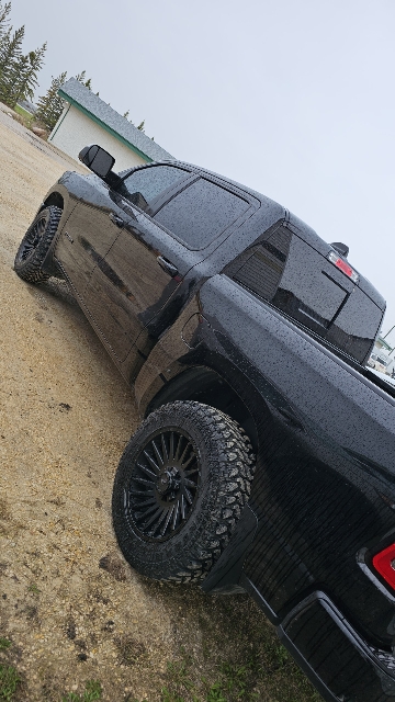

I'm running a 275/65r20 which is 34 with a ready lift 2" level with their UCA's works just fine. You won't have any issues.

That looks good man. Did you have to do any trimming?
No just slapped them on. It's very rare but if I back up into the driveway It may rub for a brief second at full lock but it's hardly every happening. Could be cause my one wheel well liner is loose
