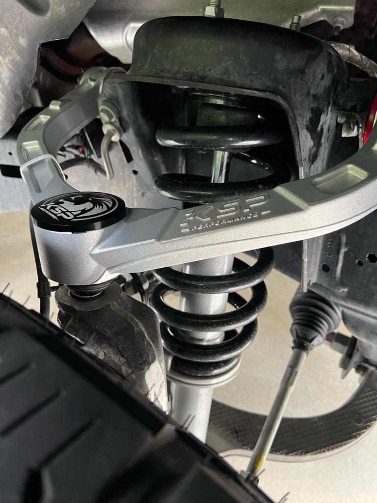

Well turns out it’s not the clips. It’s back to the drawing board but I did have the UCAs replaced with zone Off-road level kit and a new strut on thr passenger side. It sounds like it’s only coming from the passenger side so the shop I’m taking you to is going to look at replacing the upper control arms to see if that will fix the problem. I’m wondering if it’s the strut that’s making the creaking/chirping sound when going over bumps.
I once chased a chirp sound around for quite awhile a few years ago. Practically tore out the whole front end looking for it. Turns out it was the spare tire bouncing around in the back a little because it lost some air pressure over time.
Mine had the chirp it was the upper control arm passenger side replaced them with ksp haven’t heard it again I had a rip on the boot
