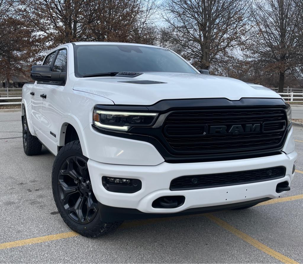

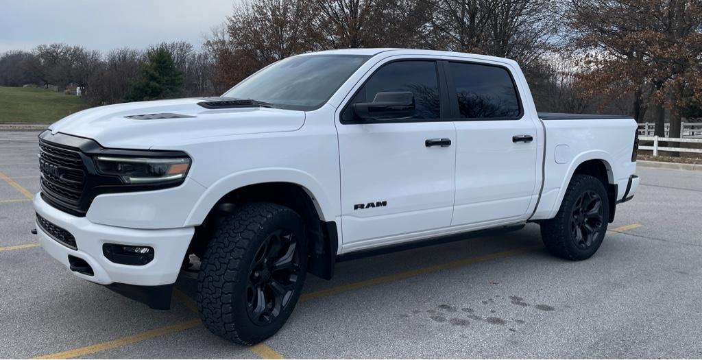

I went with the 285/55r22 Amp Terrain Pros. I like we’re it put the RPM’s when going down the highway. Love the way it looks! And no rubbing or trimming needed.
What do you think?
Very sharp looking truck! The bigger tires definitely help fill the wheel wells and complete the look. Glad you’re happy with the engine speed as well. Are you closer to 2k rpm at your ~78 mph highway speeds?
Yes, sets right at that RPM. Holds 8th gear pulling most little hills when using adaptive cruise. Used to chase itself all over with the last set up.
Love to hear that! good luck with the new setup!
