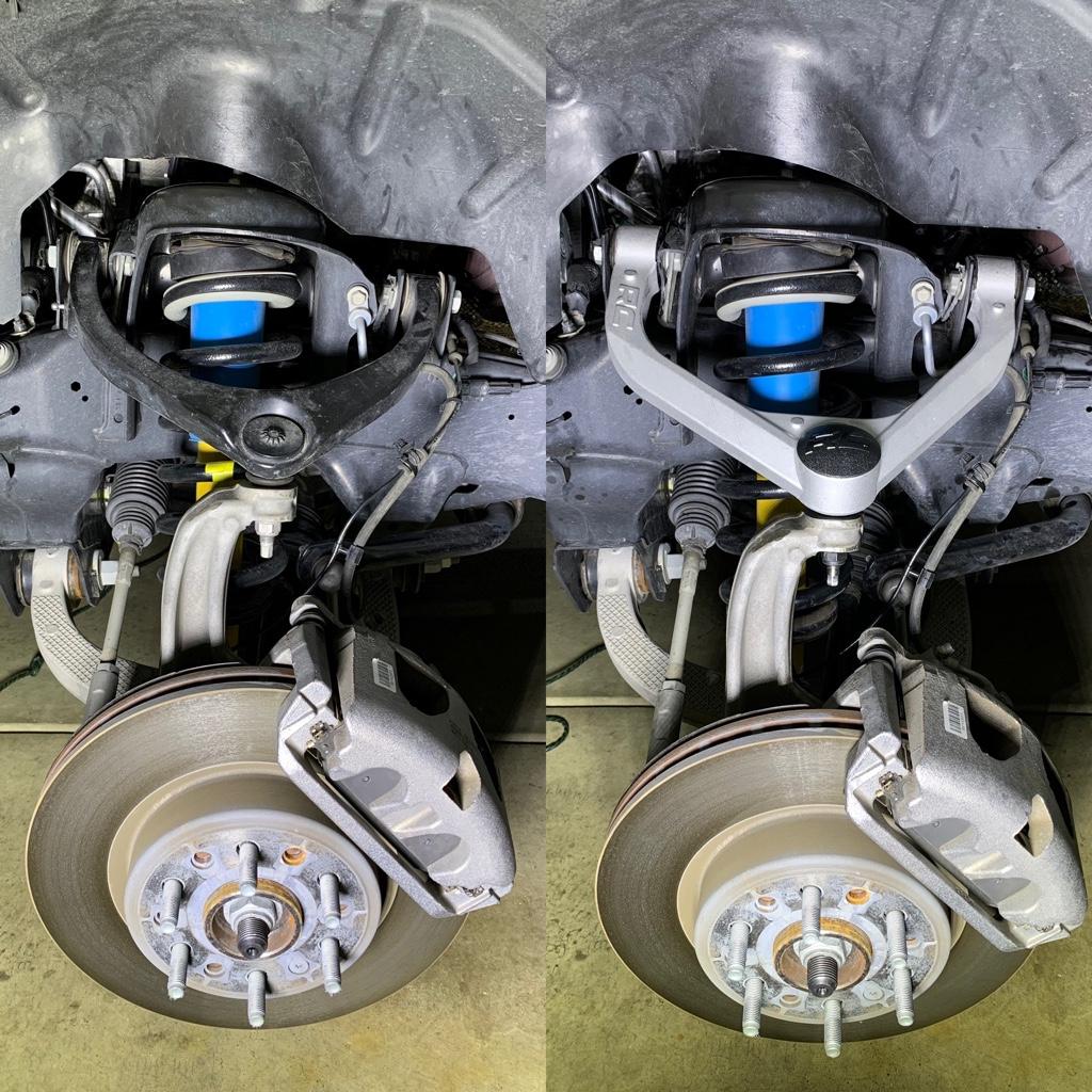

New rebel owner here. Just bought my first one this week. 2019 Rebel with 11K miles. I would like to level the front end and I know that parts are in short supply but I was wondering the best path. Should I do the Bilsteins or the ReadyLift UCA's? If you can let me know why you think either option is better that would be great. Thanks!

I installed the ReadyLift level spacers along with the new UCA's. I've had no problems in 3K miles now. Ride is just the same as it was factory also. Good luck with your decision!

Go with the adjustable struts (bilstein) and new UCAs. You can buy the readylift ones but tuff country and rough country also sell great options.
I went with Rough country and will be removing my Motofab kit in favor of a bilstein kit the second they come back in stock.
