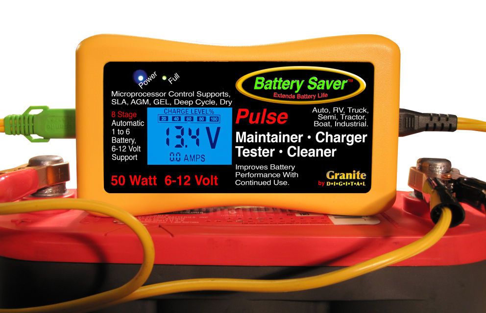

I chose to go with the Granite Digital Charger, Maintainer, Cleaner & Tester - 50 Watt (6 & 12 Volt).
  1. It is 50 Watts so it will charge the battery quickly
  2. Uses a pulsing technology to desulfate the battery
  3. Low Voltage Monitor with audible Alarm
www.batterysaver.com
This 50 Watt device Charges, Maintains, PULSE Cleans & Tests a Vehicle Battery. Works with All Standard Lead Acid battery types and sizes.
