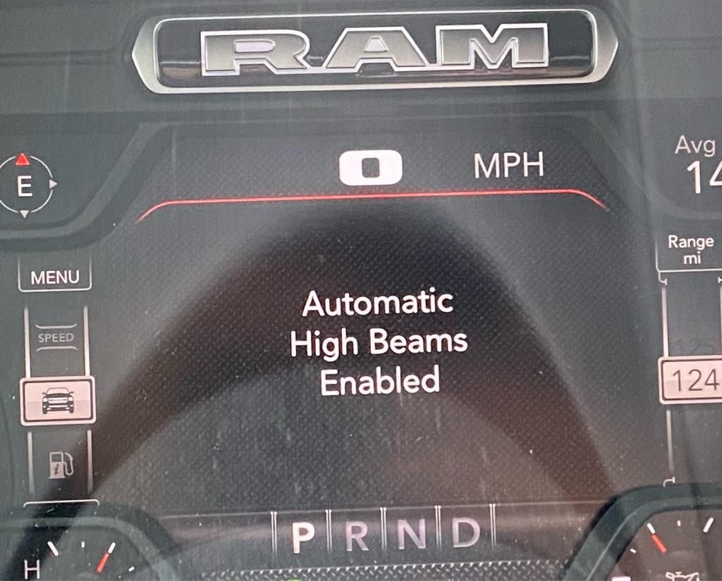

Thank you for all of the great information in this forum. I got auto high beam to work this morning. Have DASM and there was no hardware needed. Only had to change the 3 settings in the BCM with alfaobd. 2022 Ram 1500 DT Big Horn.
What were the three settings in alfaobd? I only see where you set the customsetmenu
