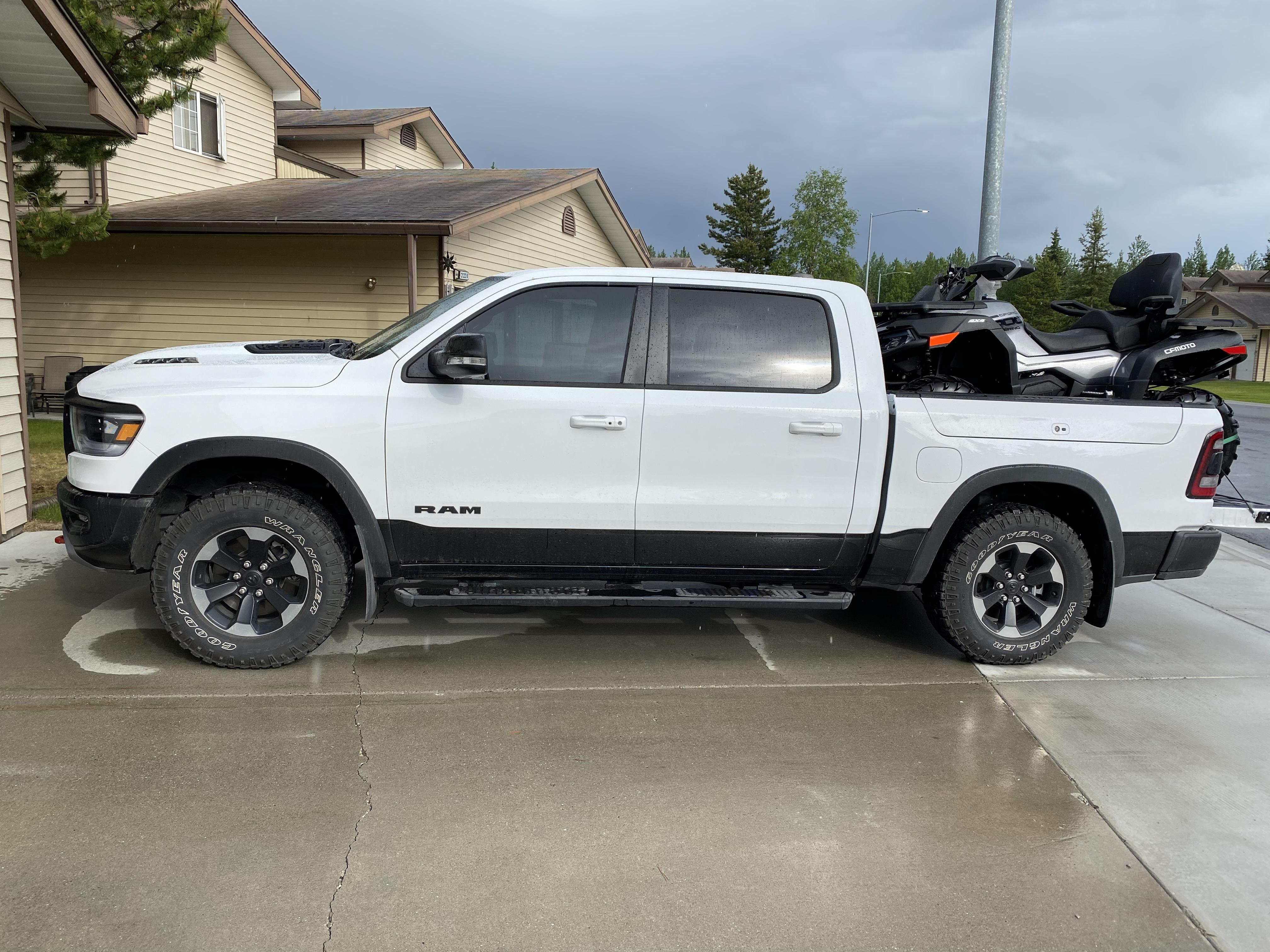

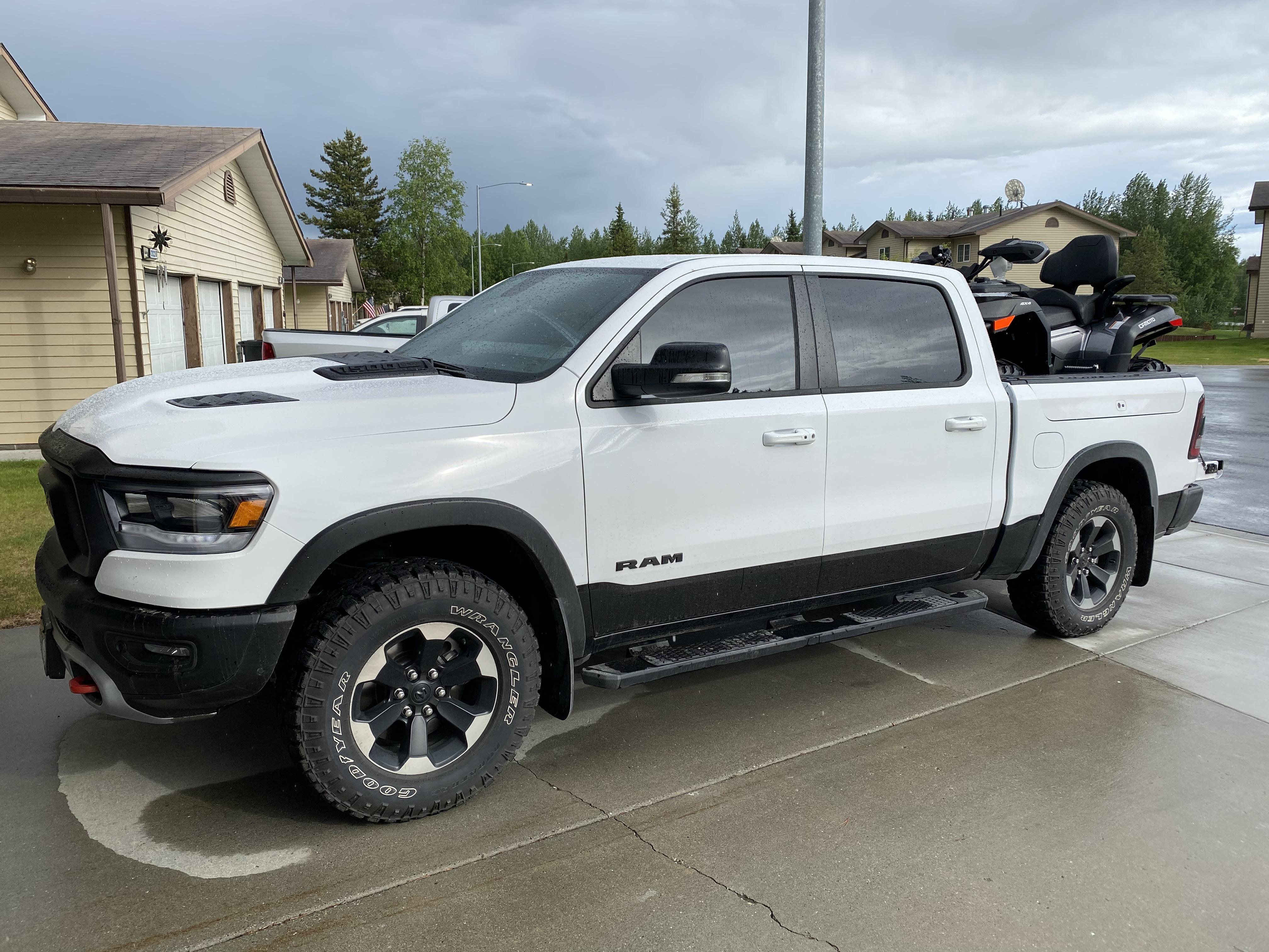

my set up. 2018 KQ 750 w ps. bought brand new, last atv 2001 bayou lasted 17years 1st guy looked at gave me 1500$ was like new, wanted bigger, KQ plows the driveway and some
neighbors well, great for draggin a deer out
also..only has 159 miles on it..i have trifold
ramps as well just easier for me to load and go on trailer..

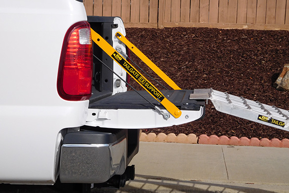

Full Size Tailgate EX Support Bars for Dodge/Ram Full Size 1500
https://www.dgmtailgatesupport.com/...gate-ex-support-bars-dodgeram-full-size-1500/
I use these for my 700lb Harley in my 5'7" bed with the rear tire sitting completely on the open tailgate. These take just seconds to install/remove with no modifications at all and add huge piece of mind, should the tailgate cable break or rip out under stress. $65 for any brand truck. I leave them under my backseat for whenever I need them. And I use wooden ramps for my Skidoo, aluminum ramps for Harley.
Bought these when I bought daughter a Polaris Ace 150. Not sure if they were needed but as stated, huge piece of mind just in case! Definitely recommend.
