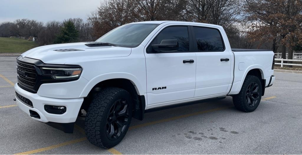

Search the tire size in the forum. Several posts about this and pics of both tire sizes on trucks. I chose the 285/55R22 as it kept the stock width. Running a 23 limited w/air suspension. I can use all levels with no rub.

I have the same vehicle and that’s interesting. What tires are those? Are they quiet? And lastly, do they affect the speedometer accuracy? Thx in advance and love the ride!

Amp Pro Terrain. A little road noise, but minimal compared to others. I drive highway for work and have put 20k plus on them and handle great. As for speedo, yes, this size is almost a 35” tire. You will need to get a bypass cord and OBD scanner to change tire size. Note, entering a size over 34.4” or there about disables front sensors and other features.
