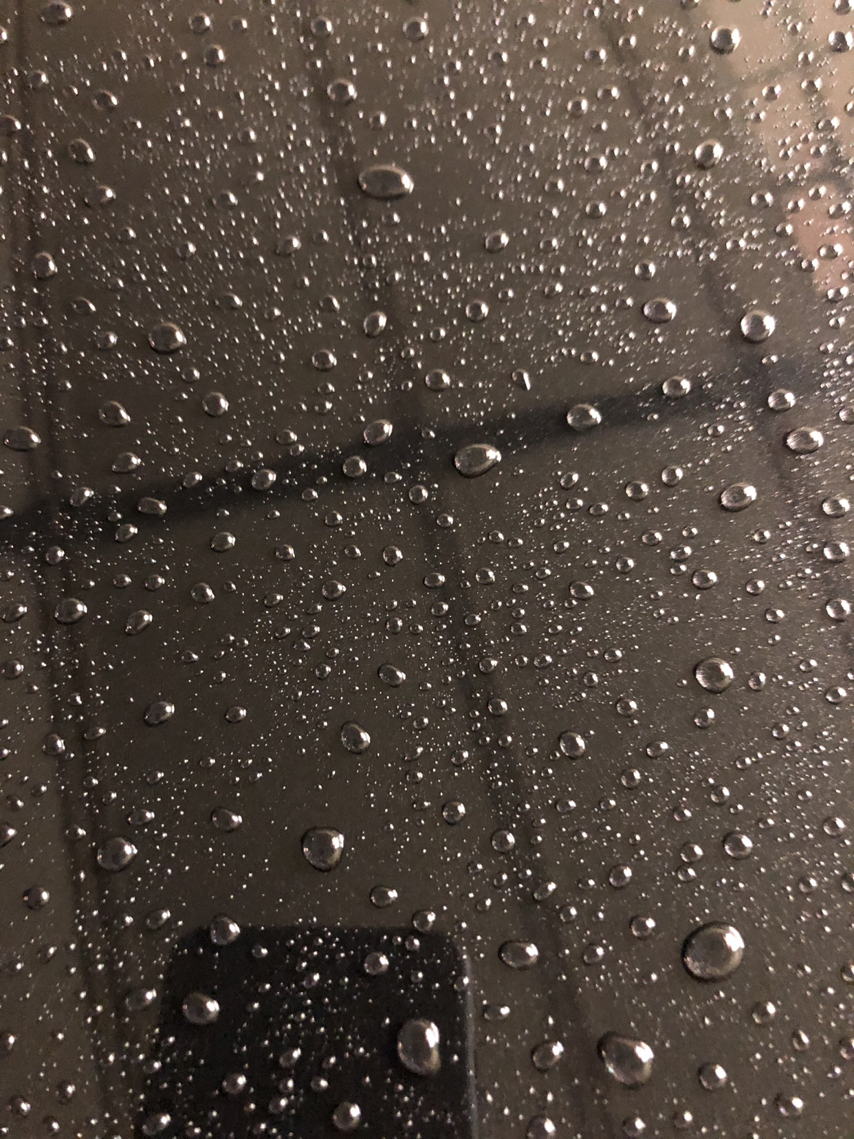

I’m debating Tac Systems Sparkle, PA color match Cosmic or Cosmic V2.
Here is our Taurus that was done 2 years ago In April with the original Cosmic. I topped it once with Cosmic spritz and 2x with High Gloss (last app 4 months ago). This is after some rain 2 days ago.
I have been very impressed.
