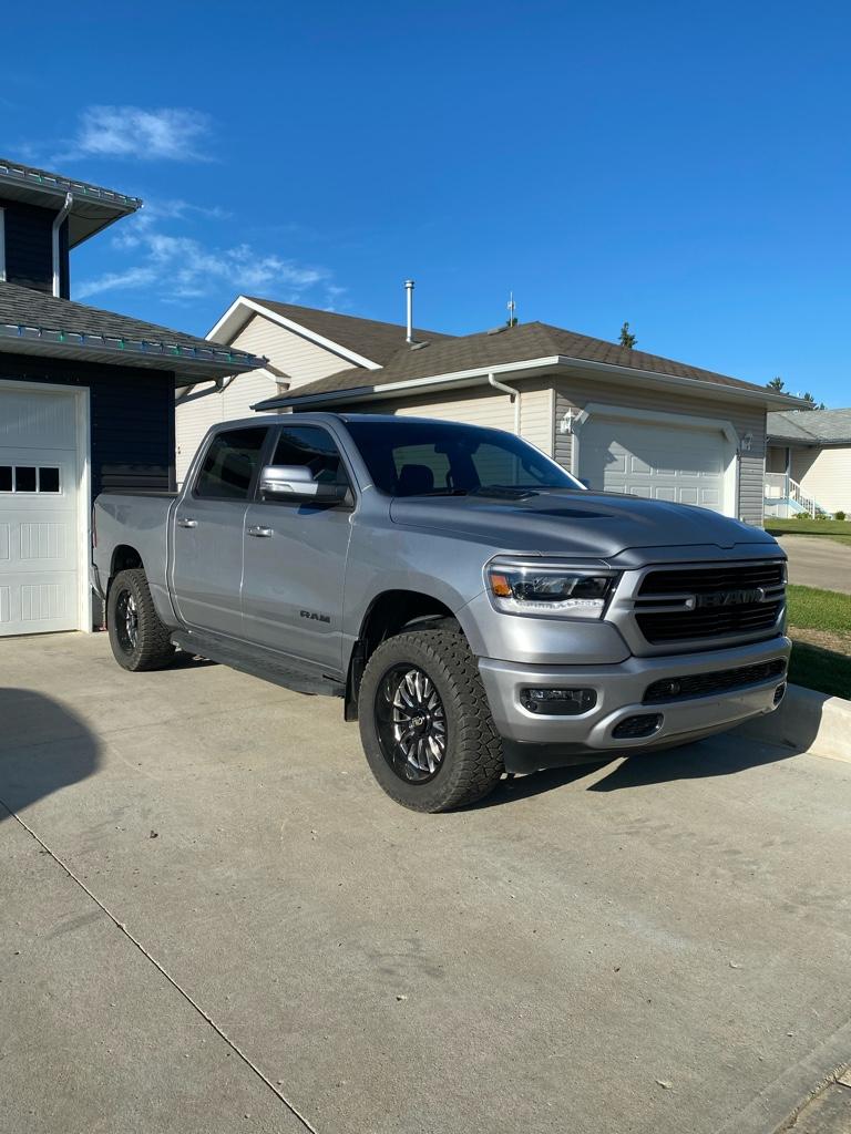

I had 285 55 20 on zero offset wheels and no rubbing liked them with no level. Once levelled they weren’t big enough
Would they rub if you used the factory 20” rims without level or ORP? Wanting to fit biggest size tire on stock sup.
Don’t know forsure but I would think they would be fine I had lots of room.
I have LT 285/60r20 on my 2020 they rub a little on full turn forwards and in reverse, on my 2019 with air susp they only rubbed slightly in reverse, thats with the factory molded mud flaps, probably wouldnt with out them
How much did the 285/60/20s fill up the wheel well? Was it too much or would I be better off getting the 285/55/20? I’m going be getting falken Wildpeaks AT3W soon
It originally came with 22" wheels, found tires to be scary on my hiway commute, and not many choices for at tires in 22"
They look perfect not too big or small. Where do they rub roughly besides the molded mud flaps?
anyone wearing them on stock laramie wheels/suspension ? do they come flush with the oem fender flares ? would like to see some pics before i buy . thanks
