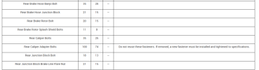

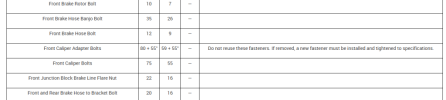

Good day.
Does anybody in here have an active subscription to Alldata or work for a dealer as a mechanic?
I am trying to find the torque specs for both front and rear Caliper Bracket bolts and Caliper Slide pin bolts on a 2022 Ram 1500 DT Body Style Crew cab 4X4 with Hemi
Before anybody asks i have checked Internet and the results are mixed.
Thx
