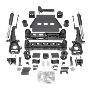

I went with the only lift available at the time when I first bought my truck, which was the RC 5" kit. Shortly after, BDS came out with their 4" and then Readylift came out with a 6". I saw it mentioned that Revel was using RC lifts in their kits and I haven't seen any evidence of that. I'm currently in the process of swapping to their Ultimate Lift package which combines the ReadyLift 6" Air-Ride lift paired with Daystar front 2" spacers and the revel links to raise the rear the additional height needed for a level stance. Should give it about 8 inches total lift without having to do a body lift like others and losing the front tow hooks or worrying about the exhaust tips and tow hitch looking funny.

Have you finished with this install? Looking to go the same route and would love to see pictures and hear feedback.
