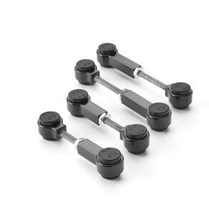

Hello I have had the dealership do a 24 hour leak test on the air ride system. No leaks. Truck sits about an inch lower rear driver side. Can anyone tell me if there is a way to adjust just one wheel or air bag ? Appreciate any help or suggestions. Truck is a 2019 Ram limited.
Since you have no leaks you could try picking up some adjustable suspension links. Stock suspension links are fixed, but with adjustable links you could tweak the suspension height at each corner. There are many different companies making them, and you can make your own as well. Here’s one example…
Wow thanks Mike I will definitely look into this. Have you used them before and is their a brand you’d recommend
Yes, I've used them for leveling. Sorry but I don't remember the brand I went with. It was on a truck I no longer own.
I USED AIRLINKS AND THEY WERE GREAT ALSO OWNER IS U.S. VET AND MADE HERE IN U.S.A.
