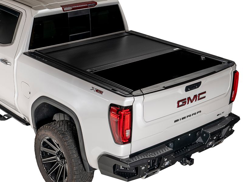

TONNEAU COVERS & TOW HOOKS
What kind of Tonneau covers do you guys recommend? I was thinking of these:
Unless there are better options out there?

tonneau covers:
pick one that you like the looks of, Ive never seen one that is so bad i wouldn't buy it.
If you spend $500, you are going to get a nice and simple cover that does what it says it does
if you spend $1000+ you are going to get a fancy bed cover that does what it says it does

Since the bed cover thing wasn’t elaborated on... if you actually plan on using your bed, over the years of having trucks, the tri fold has been the best fit for bed usage vs seal vs protection, The Bak Flip allows 99% of the bed space usage. Rough country has a tri fold for about half the $$ but it is really only bi fold you can only flip 2 sections out of the way.
A fiber glass shell, best seal for cargo, probably the most protection you can have all around but it is the most inconvenient bed cover if you use the bed for anything that is taller than the rails.
Roll and locks are neat too, but the rails take up side to side space and about 6-9” of the front of the bed to house the canister, so you loose some of the bed space.
Now hard vs soft, I would do hard covers vs soft because they are more durable, and tend to last longer without leaking or readjusting. If you off-road much, the constant shifting and banging of the truck tends to make the soft clamp on type shift and re quire re adjustment. I have been on trails with friends, and their soft clamp on did not make it home cause it fell off along the way. But the clamp on style is also fast to install and fast to remove allowing 100% useage of the bed.
So ask yourself how do you plan on using your bed?
