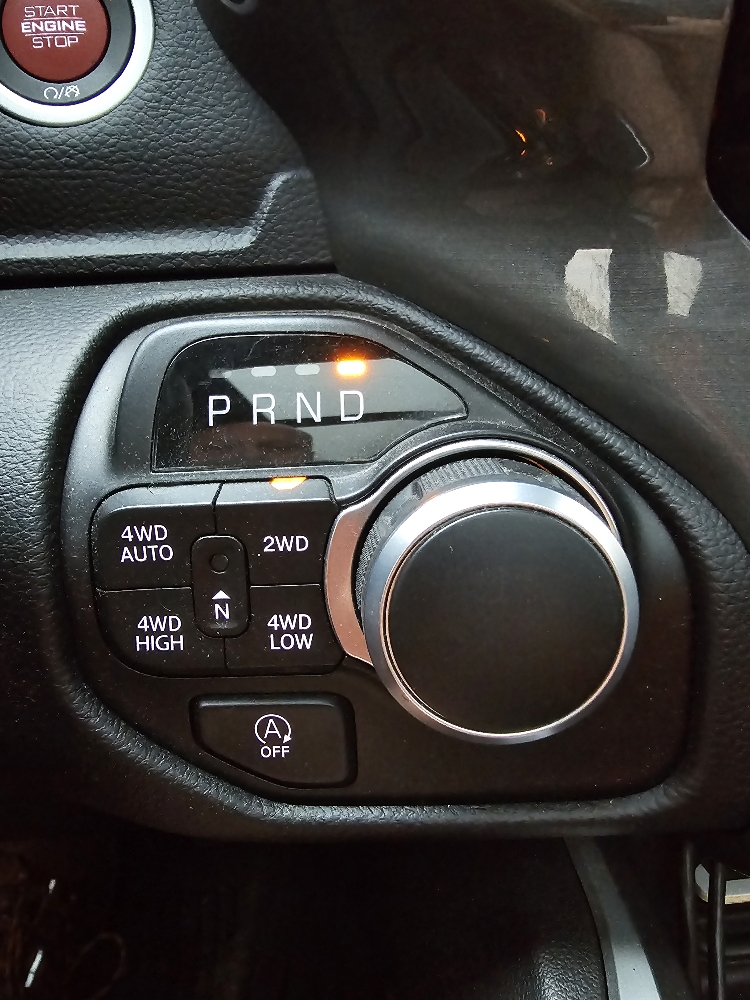

This kit is for the 1500's and looks to have the correct switches the OP is looking for. Should have all PDC included as well. Being abel to order one is a bit of a different story as, if memory serves, they are consistently out of stock although thay may be behind us now. . Genuine Mopar Auxiliary Upfitter Switch Kit - 82216449AB | Mopar Genuine Parts
If the image is correct, that panel has hill descent and I believe someone already stated it doesn't just work as TH by position alone.
Not sure why a 1500 switch panel would have hill decent switch on it, since that button is below the shift knob on trucks equipped with hill decent. I think the button you are looking at is the AS/S disable button for etorque trucks
Could be. Regardless, it's not the panel the OP is looking for.
The disable button for AS/S is under the shift knob and 4WD buttons.
I don't have it on one so didn't know. Can you tell what that button is for in the picture? Looks like it has an arrow pointing to a gauge, which is why I thought it was starti/stop
That's what the button looks like. I've never seen the other one.
