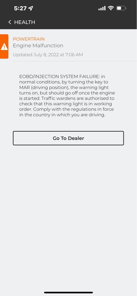

Removed both yesterday today I get alert on Uconnect app but no check engine light this is the alert if anybody has a fix
nothing like that on my end. Its being a month and all good.
I don't think its due to removing the ADD.
A not so detail search points to fuel contamination as one of the causes but it is recommended to check with the dealer.
Are you loosing power or truck stalling.
I think this issue was mentioned in a HD forum,
fuel pump? or faulty sensor? maybe
Hopefully some one else will have some better advise
No everything seems good except for that message in app
Removed mine on a 2022 and have had no issues. Unfortunate coincidence
I tried putting back aad and seems to have cleared the alert on Uconnect app
