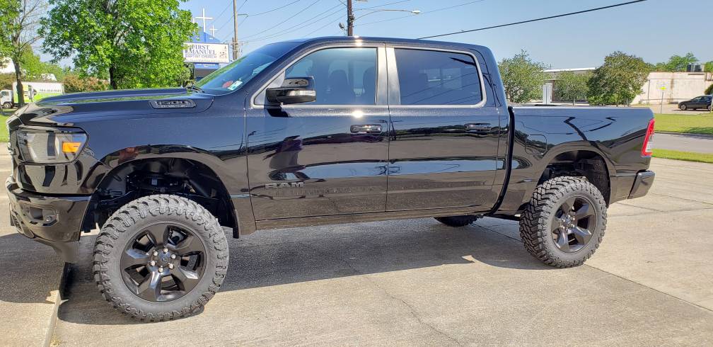

Do you have any pics of your truck on a level surface? Curious to see if the BDS kit has any rake. My Fabtech kit sits about an inch higher in the back and it bugs the shït out of me so I wanna see if the rear BDS coil makes a huge difference.
[/Q
Mine might not be the best comp because I have the ORP which has longer struts. BDS recommended we leave out the 7/8" preload spacers in front suggesting the truck would be 3/8" higher in back if we did. Somehow, that did not get communicated to the Tech that did the install so now mine is slightly higher in front. It's pretty subtle and it's not driving me crazy yet so I figured I'd put some miles on it and see how things settled out. I am traveling this week and this is the best picture I have on flat ground. If you need a different perspective, just ask. I'll follow-up over the weekend.

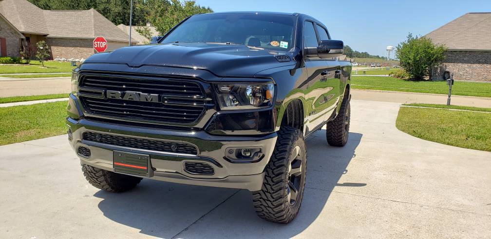

Here is another picture more straight on side shot. Again, I'm a little high in the front but it's not bugging me too bad yet.
