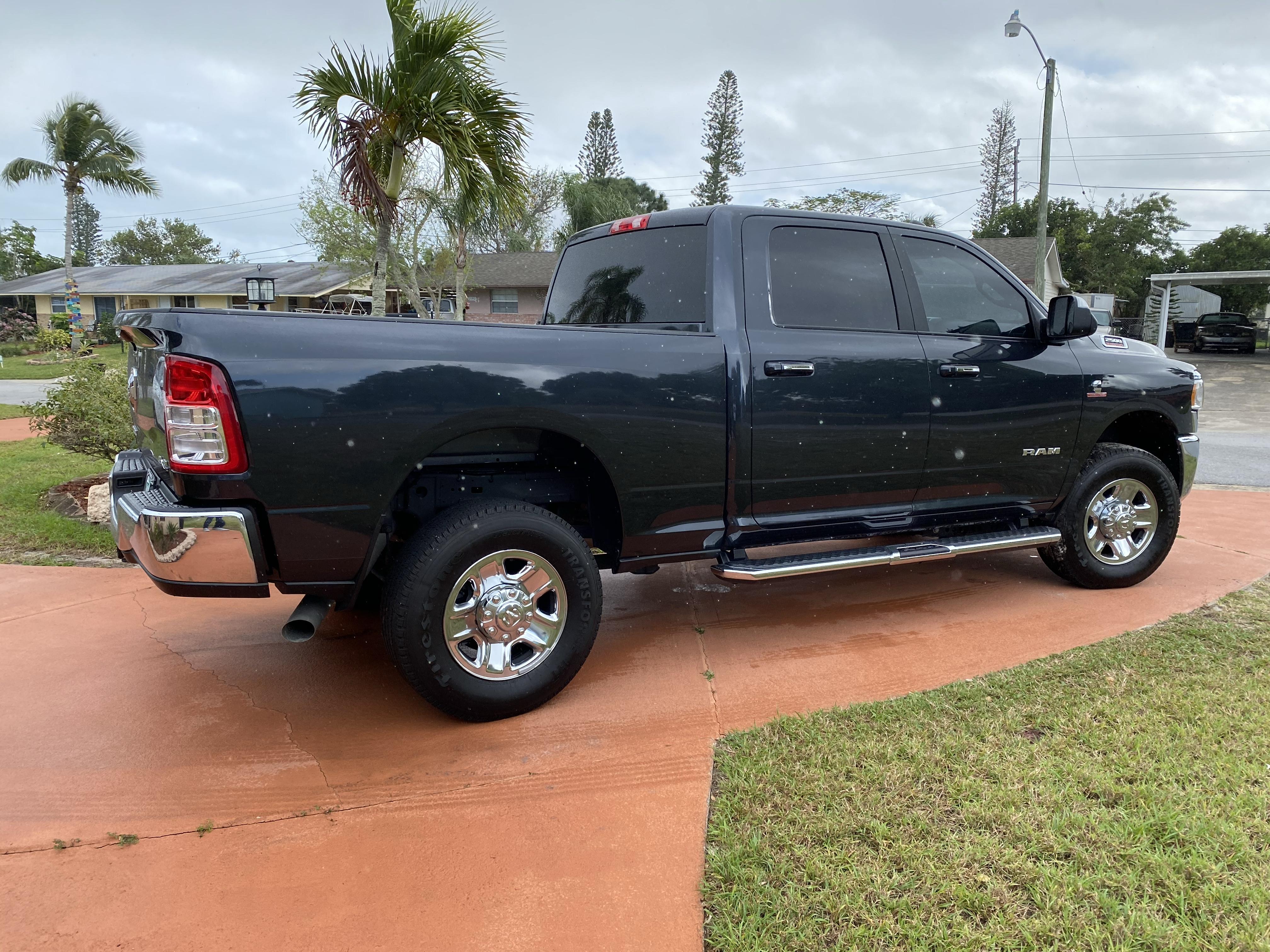

I’m running 35-12.50.20 Thunderer Ranger ATr on stock 20’s , best kept secret in the tire market, tires are just a tad over 34”, no spacers required

Will be lifted Friday with Bilstein at 2.2 and 1-1/2” in rear , currently raised with floor jacks, - 760.00 free shipping —eBay

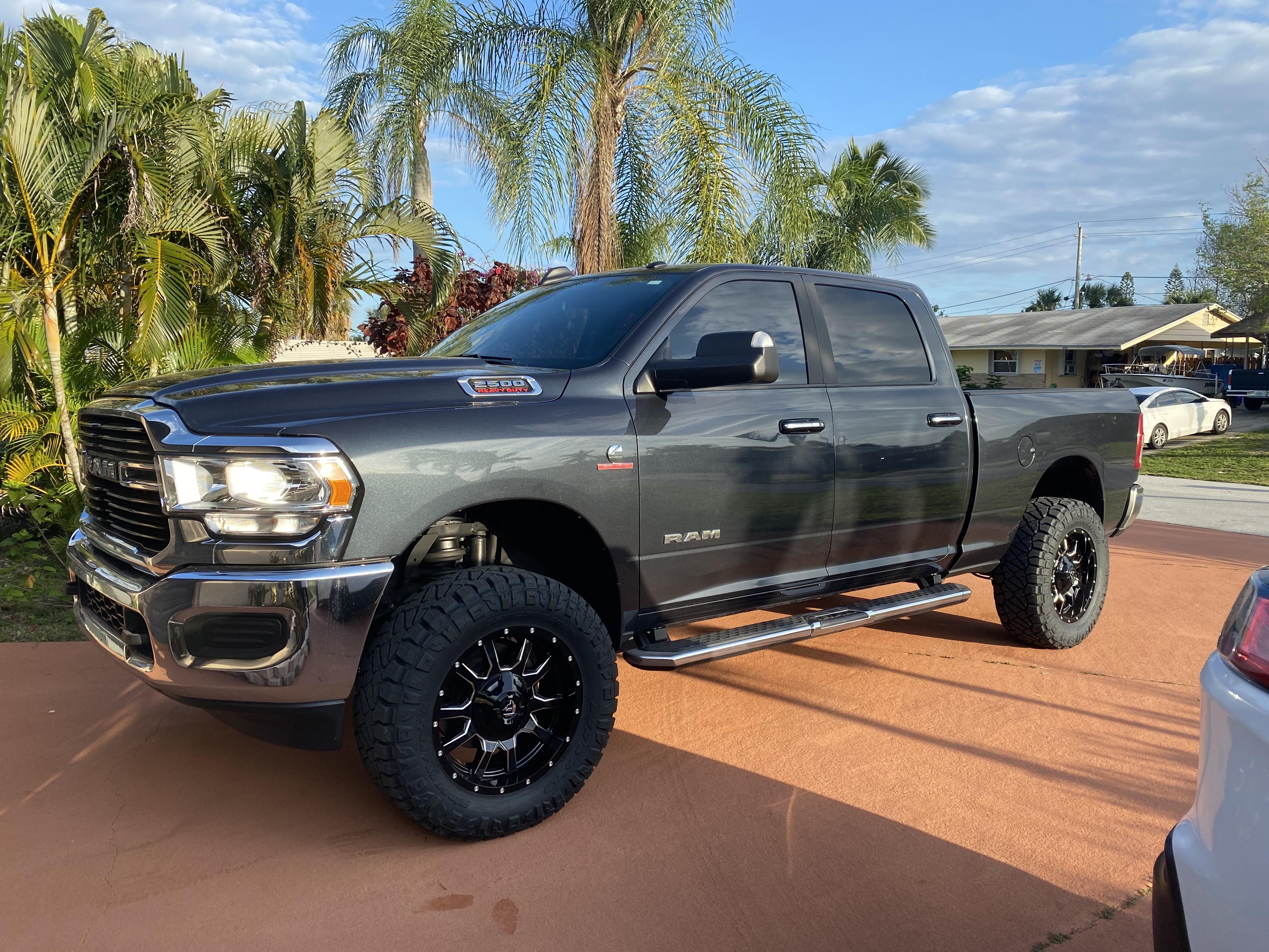

I just installed 35's' on a level yesterday, not stock rims tho rebel pdf.jpg

thank you! im really happy with how it turned out. My tires are 12.5 and wheels are -12 offset.... they rubbed those plastic mud flap things off right away. the ones that sit right behind the front wheels. with those off, the tires only occasionally rub the retainer clip tab thats behind the fender liner where those mud flaps were secured into. theres a nice write up on here on how to remove that and gain some extra space, i should be good once i take care of that today. I think youll be able to run 35's fine with similar rubbing that i have, maybe check out 35x11.50 tires.
