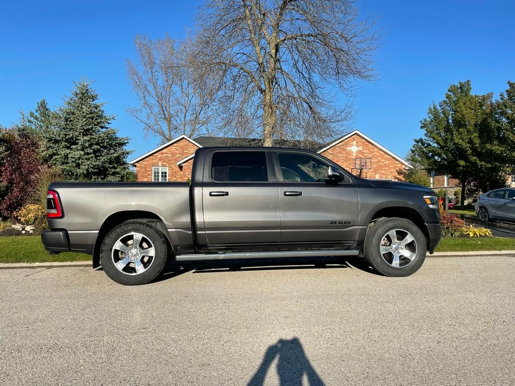

Just installed a 2” level and lt275/65/20 tires on my 2019 Sport . No issues with clearance at all.

Bridgestone Revo 3 A/T LT275/65-20 on stock rims. Lightest 34.1” tire I could find (51 -52lbs).
Ride seems smoother than stock tires (larger sidewall - even though an LT), though slightly noisier as you would expect with tread.

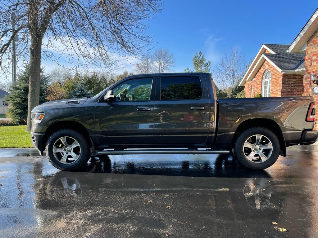

mine has 35x12.50r20 Mickey Thompson Baja Boss AT's on the factory wheels with no spacers or after market lift. ( I do have the ORG W/ Air ride) The 275/65r20 is only a 10.8" wide tire so you will not need wheel spacers or different UCA's. (that's how wide your factory tires are also by the way) My tires are F range and heavy at 73lbs a piece my truck has zero problem moving them. Also the ride has greatly improved over the factory wildpeak at it came with. Everyone it seems on the internet as of late gets hung up about the weight of their tires. Honestly unless you're trying to save a seconds on race day it honestly doesn't matter. Your truck will not care if it spinning a 40lb tire or a heavy 73lb beast going down the road. (still getting 17-20mpg btw)
