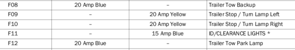

Fuses are listed in tabular form on page 394 of my Owner's Manual for my '21 Big Horn, perhaps they are in yours as well. The ones associated with towing lights are F08 through F12, located in the External Power Distribution Center, left side engine bay looking forward, near the battery.
I would guess the running lamps are a cartridge fuse, F12, but it'd depend on your truck.
