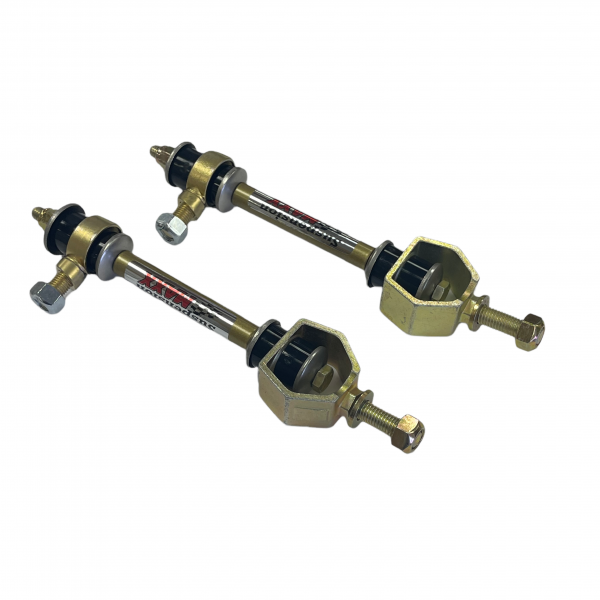

That's your sway bar end links. Highly suggest upgrading to the Suspensionmaxx end links. Better quality, rebuildabke, and will increase the effectiveness of the sway bar because they are stronger

It's a ball mount style fitting. It will rotate like that.

Think about the sway bar attachment points. You have two on the body, so when adding any lift to the front end, you're raising the bar some also. By keeping the factory endlinks, you're straining the angle of the sway bar and pulling it down. You need the longer endlinks when doing a lift to keep the sway bar in the proper alignment. Too much strain and you'll wear out those endlink ball joints really quick.

Install the Suspensionmaxx sway bar end links. And get some polyurethane sway bar bushings and see if that helps. If nothing else it will improve handling
