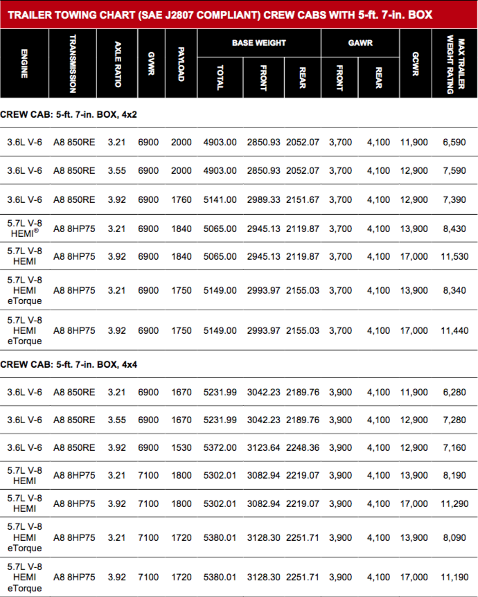

Ram has released the payload and towing charts for the 2019 Ram 1500 V6 eTorque, 5.7 Hemi and 5.7 Hemi with eTorque. All launch cab configurations and box lengths are listed, Quad Cab 6'4 box and Crew Cab with 5'7 and 6'4 box lengths. This also serves as our first official confirmation on box sizes with them remaining the same throughout the lineup. Also present is the Quad Cab HFE model that we have not seen yet. Check out the towing and payload numbers below
Source: FCA Media
Source: FCA Media
Source: FCA Media
Source: FCA Media
Hello, Im shopping around for a TT and have been trying to locate these types of towing specs for my 2020 Ram 1500 4x4 Limited. Keep getting this message on the Ram website, any suggestions would be appreciated. Thank you.
All of this info is on the two stickers in the driver side door jamb. In fact, it's the only accurate information for your vehicle. These online towing specs are generic and don't account for your specific vehicle trim/options/accessories.
Found it, thanks Brandon! Bummed out that the payload is so low, hadn't planned on purchasing a TT until recently so I'll have to purchase accordingly or upgrade to a 3/4T.
Yes, Limiteds are quite limited on payload due to all the extra creature comforts.
Considering two people will take up around 350# on the lighter side, you’re down to 900# for tongue weight and other supplies. That’s not the end of the world.
Tongue weight, even at 15% of trailer weight will put you around a 6000# loaded trailer. Of course if you can get closer to 10% tongue weight then you’ll be up around a 9000# loaded trailer.
These two numbers disregard any additional weight in the truck besides the 350# I assumed for two people. Remember too, the payload number on the sticker considers curb weight if the truck, which includes a full tank of fuel.
