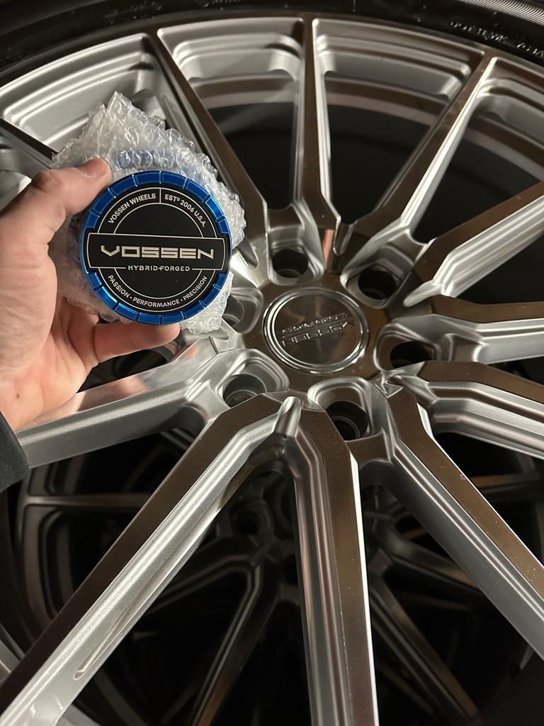

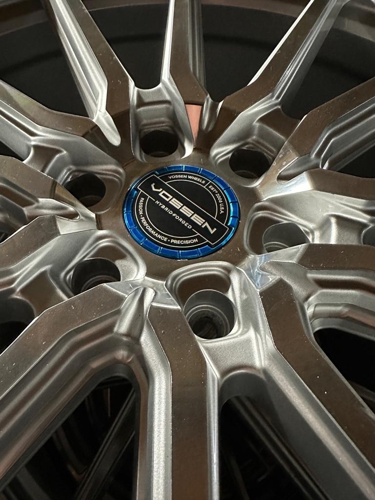

My buddy is friends with VOSSEN and got me a late Christmas present. Matches my mopar badge and should look good with the black lugs
