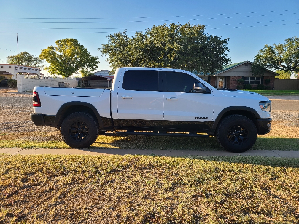

That's clean, no rub even at full turn? Fills out the wheel wells real nice
No rubbing at full turns. They are same diameter as Rebel stock wheels. The main difference is TRX wheels are 9" width vs 8" with the stock Rebel ones.

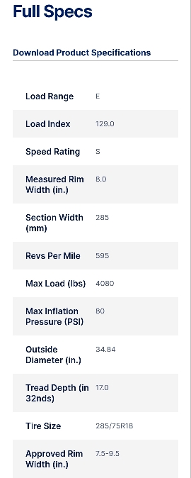

Reviving an old thread here but I'm confused about one thing. The 285/75 r18 shows a recommended rim width of 9.5" yet the oem rims on a 21 rebel shows 8" what am I missing?
The tires I have, Cooper Discoverer AT3 XLT, say they are good for 7.5-9.5
