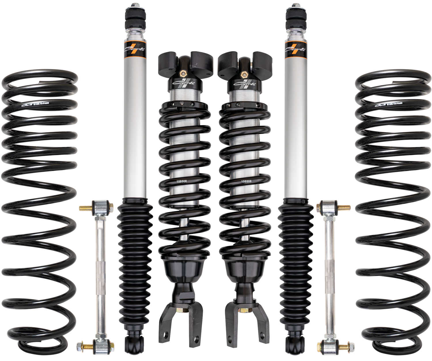

Has anybody here put the Carli commuter 2.0 system on A 5th gen rebel? If so how much lift did it produce front and rear, and how much did it improve ride?
boogielander
Jun 29, 2022
1,905
2,716
According to Carli's website:
Hemi Front Lift​
Rear Lift​
Front Travel​
Rear Travel​
Shock Diameter​
Tire Fitment​
1.5″​
1″​
8″​
12″​
2.0″​
35″ x 12.5​
I went with basically Fox 2.5 plus Carli's UCA, rear springs, rear end link. Ride is major improvement when compared to stock, and I have adjustability for on road dampening and off road dampening.

Put the system on last week. Does not seem to have lifted the front at all and maybe 1/2" lift in the rear. The truck does not go offroad any further than My back yard so the amount of lift is not A problem for Me. I am not going to go wild on the tire size and did not really need any lift. I will Run the factory tires until fall and then plan on going with 285/65/18 K02s on TRX take off wheels, that will give A little more width but with no rubbing on the UCA and keep the tires under the fenders instead of sticking out slinging crap up the side of My truck. As far as the ride goes, it is an unbelievable difference. The truck now rides as well as A late model Ford raptor or A large luxury car.

I have this with Rebel HD springs on my Laramie as well. (500 pounds constant load) I agree that I did not get the advertised lift in the front, maybe half an inch or so over stock ORG. Got enough to clear 285/65/R20’s which is good enough for me. Only about 500 miles on the system so far so not fully broken in or settled, but so far, very happy with the ride quality.

This is the deal breaker for me. Plus, yeah.. the 35s fit but they look super stuffed. The Fox 2.5 at least claims 3" lift.. Back to square one.
