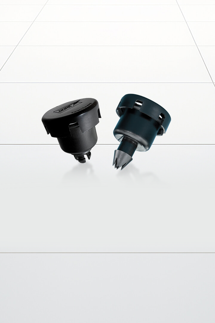

I don't know if anyone cares but I also installed extension tubes on my front differential and transfer case. It seems like the end plug cap is actually pretty decent. Here is the exact part being used that I found based off my research:
From the website:
Axles, limited slip couplings (LSCs), transfer cases and power transfer units (PTUs) must perform reliably under rigorous conditions like splashing, submersion or weather extremes.
While other venting methods can protect against most of these conditions, they can also complicate the vehicle design, cause manufacturing issues, and increase labor costs. Validation expenses may also be higher if multiple designs are required. Other venting methods may also add to the vehicle’s weight – making it more difficult to reach weight reduction and fuel economy targets.
GORE Automotive Vents for Drivetrain & Driveline Components deliver high performance in a compact, patented design that:
  • Blocks entry of environmental contaminants like dust, grit, dirt and mud
  • Prevents water intrusion by withstanding rain, sprays, splashes and submersion
This patented technology is also highly versatile: It’s a single solution to multiple challenges inherent in designing, validating, installing and reliably protecting drivetrain and driveline components.

reviving old thread.
is that the OE cap/ vent?
