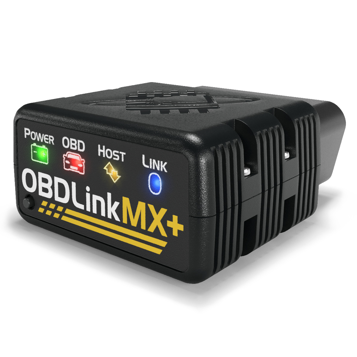

I have a 2023 1500 and want to update my tire size(275/60/20)and possibly perform a few other things. Can someone post link to what I need to buy? Will an Android table be sufficient for making changes? I have iPhone. Thanks.

You’ll need AlphaOBD through Google Play. Works on Android Tablet or phone. Next you’ll need a security bypass cable. Many out there. Lastly, you’ll need an OBD Reader. Only certain OBD Readers are acceptable with AlphaOBD. Here’s some links to what I bought and use.
I got the Koadtech Security Bypass Cable:
I got the OBDLink MX+ Reader:
Jscan works on Apple and does the same thing. It will also program fobs now.
Get a vgate MC+ for half the price of the MX+.
JScan doesn’t do near as much as AlphaOBD. It’s primarily for Jeeps.
The OBDLink MX+ reader works with both IOS on JScan and Android on AlphaOBD. Best of both worlds.

Jscan does everything alfaOBD does (and more with FOB programming). I have both.
The MC+ does everything the MX+ does. I also have both.
My only gripe with the MC+ is actually related to Android in the way they mangle BLE.

Can the OBD MX+ be used on multiple vehicles? I see it will do forscan too. I have a Ford I need something for as well.
Says it will work with Apple?
The bypass cable posted above is out of stock, will look for another one.
Thanks all.

Works with Apple, Android systems and virtually any vehicle.
I believe there’s a member here who makes the bypass cables as well.
