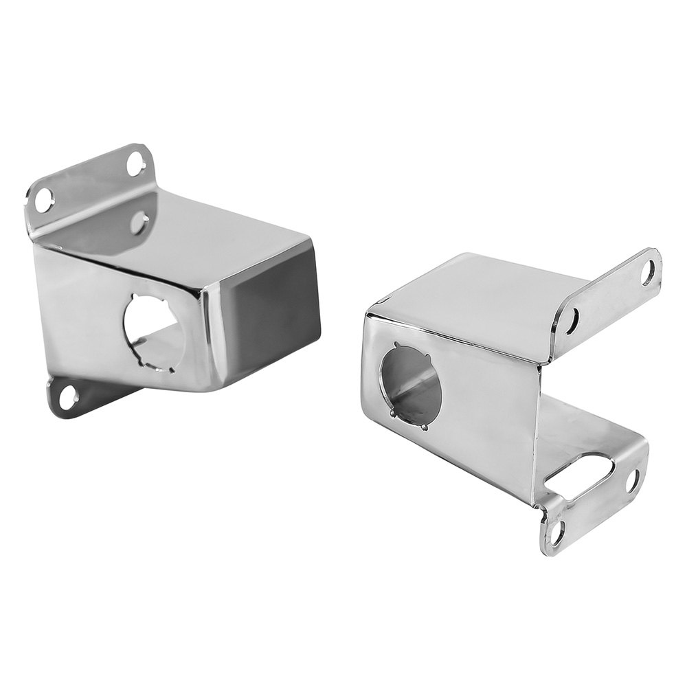

Hello, everybody. I'm new on the forum. I have a question, Has anyone tried this front sensor relocator kit? Do they work? Thank you.
For Ram 1500 2019-2020 Westin 45-0040S Polished Front Sensor Relocators
Part Number: 45-0040S

Polished Front Sensor Relocators (45-0040S) by Westin®. Westin's Sensor relocator is patented solution to OE parking sensor functionality with the use of a Grille Guard. This relocator kit includes two re-location housings that mount directly to the uprights of the grille guard. With this kit, there is no need for unsightly cutting or modifying of the grille guard that might typically reduce the integrity of the product.
Features:
  • Re-locates OE parking sensors
  • Set of 2
  • 20 gauge pigtail and connectors included
  • Mount directly to grille guard uprights
  • Patent pending
  • Drilling may be required for some front-end products

A stainless Westin Sportsman bull bar was installed on my 2019 Longhorn that I purchased used. The installation did not use the extension cables, simply unclip the sensor harness from the core support.
If I remember correctly, the sensors themselves seat into a grommet from the inside of the bumper so the cables.
The grommet seats into the bumper from the outside.
If disconnecting the cable be careful with the locking lever, it only pulls up about 1/8 of an inch..I broke one lever thinking it detached from the connector. If the harness is unclipped from the core support, sensors do not have to be unplugged from the cables.
Also, the bull bar will have to be drilled to mount the sensor relocators.
I presume instructions will notate the drilling locations on the bull bar, mine came with the truck.
