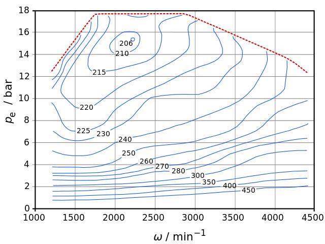

The V6 is a fine engine. Other than towing a trailer, I doubt few people are ever at wide-open throttle (WOT) in normal use.
A few points on mileage:
1) Friction is your enemy. It turns energy into heat rather than mechanical work. Generally, lower engine speeds will have the lowest fuel consumption.
2) The highest efficiency will occur close to WOT at low engine speeds. Unfortunately, the transmission will probably assume at near WOT you want more power rather than more efficiency and rev the engine faster. Tthe contours are level of brake specific fuel consumption, a measure of energy per unit weight of fuel in gm/kWh. But the key is brisk acceleration doesn't hurt fuel efficiency. The goal after that is to minimize losses due to braking.
3) The brakes convert the energy stored in the moving mass of the vehicle and convert it into heat. Basically throwing it away. Watching traffic patterns and maximizing the use of aerodynamic drag and mechanical friction to slow the truck will conserve fuel. That energy will be expended anyway.
4) The eTorque mild hybrid is nice, but it is a shame they didn't drive the A/C compressor and engine water pump electrically. Maybe a future version. Anyway, the auto feature of the A/C will manage the compressor, blower, and recirculation to rapidly cool and efficiently maintain cabin temps on a warm day. Manually controlling them is nearly always less efficient.
5) Tire pressures and tire mass contribute to efficiency. That is probably why LT tires are few and far between on the Ram. Big diameter all-terrain tires are not fuel economy enhancer.

If you have access to specific fuel consumption curves for the Ecodiesel, Pentastar and Hemi please post them. I have unsuccessfully searchd to find them. I am awaiting delivery of a new Longhorn 4x4 Pentastar air suspension 5'7" Rambox to replace my current 2014 Ecodiesel Longhorn 6'4" regular box 4x4 air suspension regular box. The specific fuel consumption curves showing amoint of fuel consumed per hp at various RPMs is a great resource to understand what you should be able to achieve with an engine and should get around the personal driving style issues.
