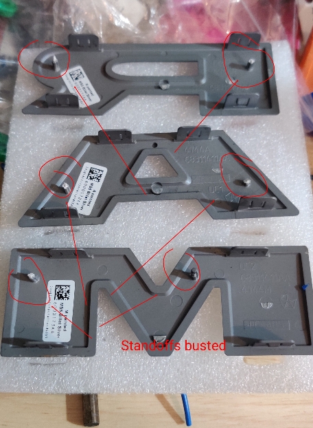

They are snapped in but also have standoffs with clips that are almost impossible to remove even if you had access from behind.
I used a plastic trim to get underneath near standoff, most of the time the clip would unsnap from pressure from trim tool. If it didn't I released the clip u pussing a putty knife from the top or bottom to release clip then apply pressure to letters and the standoff will snap. Only 1 of 6 of the standoffs did the clip slide off the standoff instead of the standoff snapping.
I replaced my letters with the blacked out version. Snapped them in place and also used 3m double sided tape since I wasn't using the clips.

For those who have removed/replaced the grille letters, if the clips and standoffs break during removal, can the broken bits be removed from the grille?
In other words, is there any plastic left that would impede insertion of the replacement letters?

For those who have removed/replace the grille letters, if the clips and standoffs break during removal, can the broken bits be removed from the grille?
You should have no problem, I know on the Rebel the letter mounts are hollow and open from behind on the grill so any broken clips can be removed if you can get behind or just let them fall out on there own. I suspect it is the same on the other trims but don't quote me on that.
