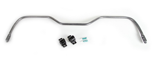

Get a hellwig sway bar! Best $200 I’ve spent in a while!
Can you describe the difference? Will it help with body roll in corners? I feel like mine is less controlled than my 2016 F150 on on ramps and such.

Second vote for the Hellwig Sway Bar. That is the exact purpose to help minimize body roll both when cornering and when driving over bumps, like speed bumps in a parking lot. I never felt like there was excessive body roll in my new 2019 Ram (Possibly since I had a 2014 for 5 years before this one), but what I did notice is that when I added the Hellwig sway bar there was an immediate improvement in body roll in corners and going over bumps. Everything just feels more planted and sturdy in the rear end now. Makes me wish I had installed one on my 2014 years ago!
I would also suggest you check out Moe's Performance, great parts supplier and he has these at the best price I could find and with quick free shipping, no sales tax (assuming you arent in Texas).
Good Luck!
Good Luck!
FYI you can buy that same model on Amazon for $223.54 and free shipping. Your link shows those guys selling it for $248.38

Also, can you install the Hellwig sway bars on a truck with air suspension?
Good call. I just bought mine a couple weeks ago and Amazon was $254 or something like that at the time.
And also I have air suspension. This can be installed on any trim and driveline, they are all the same.
I have the hellwig on mine with air suspension and have none of the issues you talk about. I think my truck rides great and I don’t know if the hellwig is a big reason or not. I installed it like a couple weeks after getting my truck. Definitely doesn’t have any additional sway or bouncing up and down.
