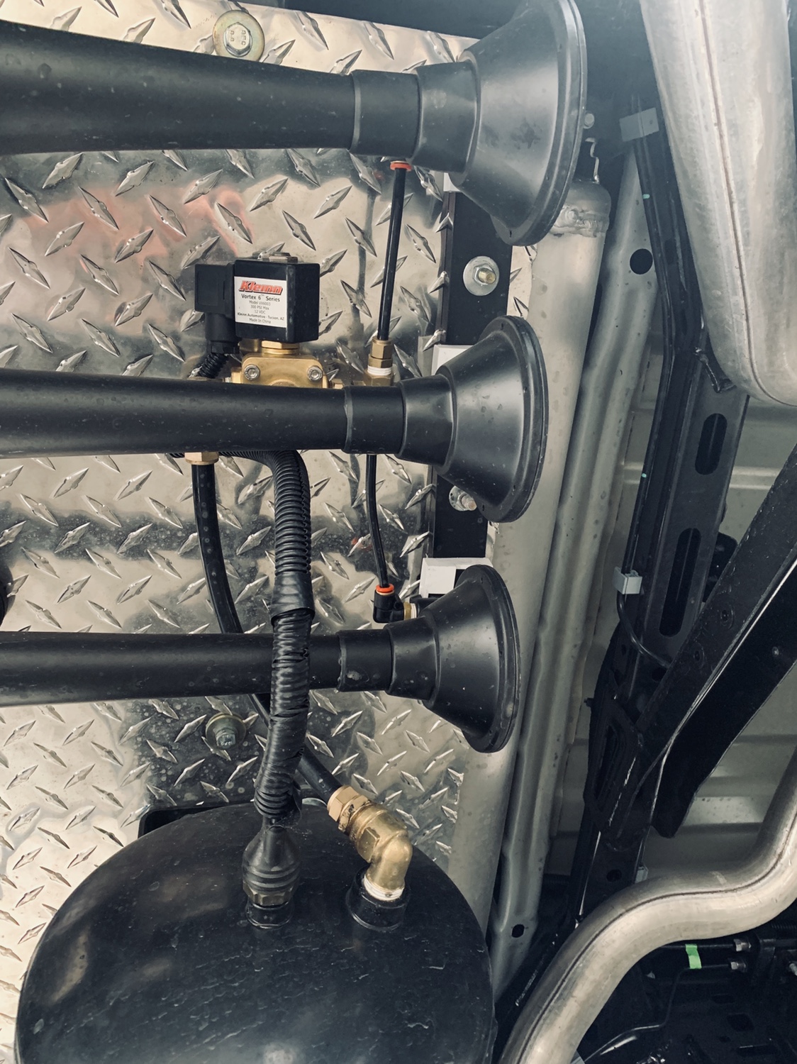

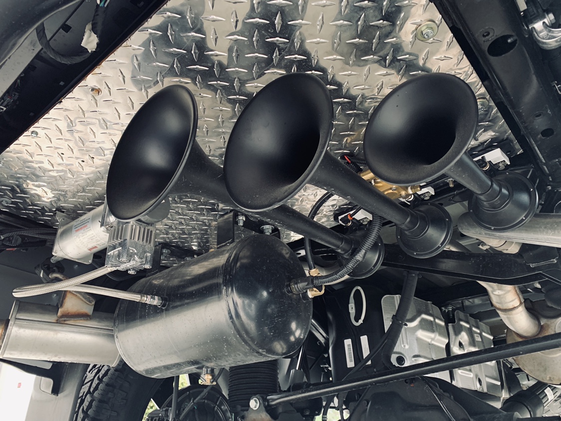

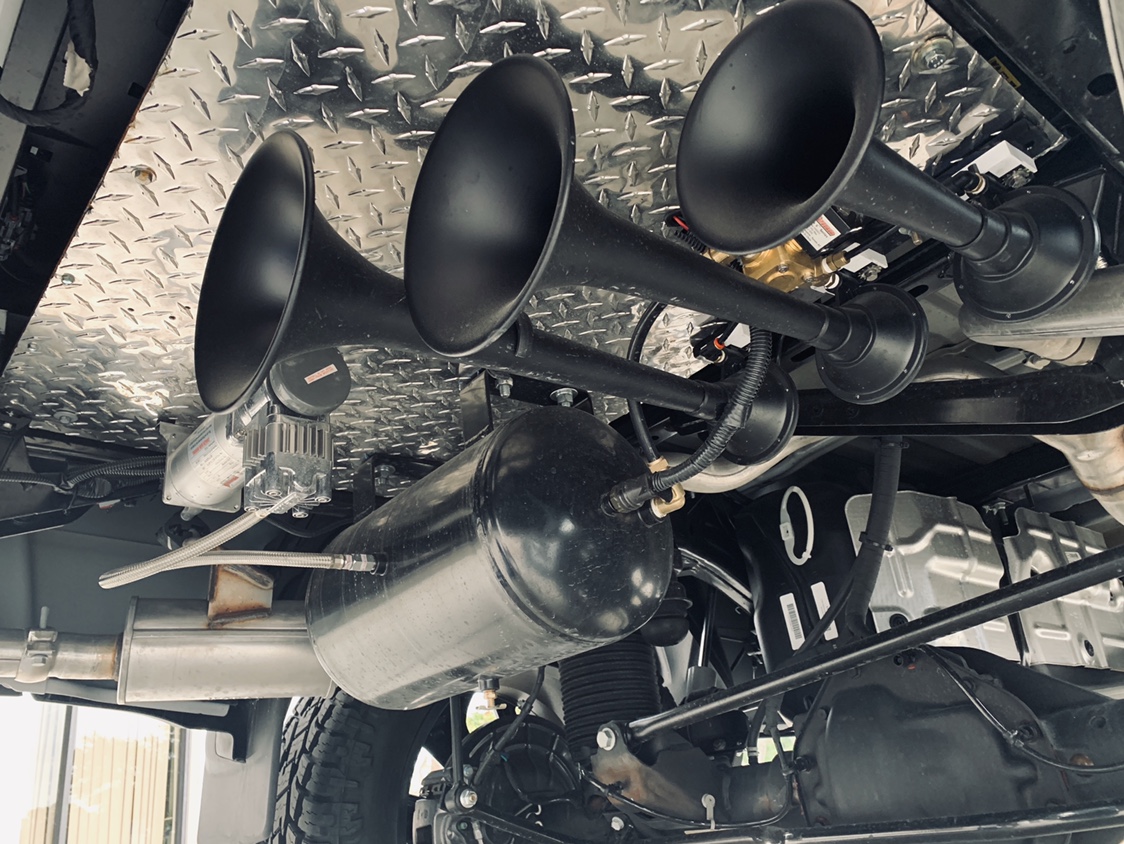

I wanted to wake up the mutant Florida drivers that annoy me. So the horns got added. Kleinn H7, and poof... a little aide to wake up the dead.

I did this on a Class A we used to own but I put a relay in so that the air horn only worked via the steering wheel horn button while the engine was running. Engine off was the electric horn.
That way kids wouldn't wake the dead accidentally at a camp site and if I ever got pulled over, I'd just shut it down. "What air horn officer?"
