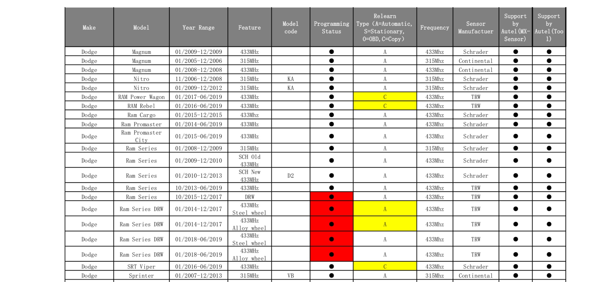

For those that did have the aftermarket sensors “activated” did they use a tool like this?
The reason I am asking from the picture below it looks like the tool is using the info programming from previous years and I heard that the 2019 uses a different data stream.
