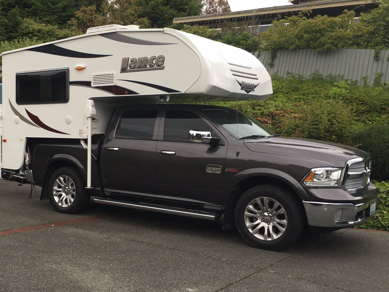

The lance 650 has a dry weight of 1700 pounds, and a wet weight of 1900 pounds. There is no ram 1500 that can support that weight, especially not with a diesel or if you are running a bighorn or "better" trim. Then you haven't even climbed into the truck yourself yet, nor added any cargo.
Then you want to pull something a trailer at the same time? You are going to be many hundreds of pounds past your available payload.
Doesn't matter what they say; almost every truck camper out there requires a 1 ton, or at the very least a 3/4 ton for the smaller ones.
