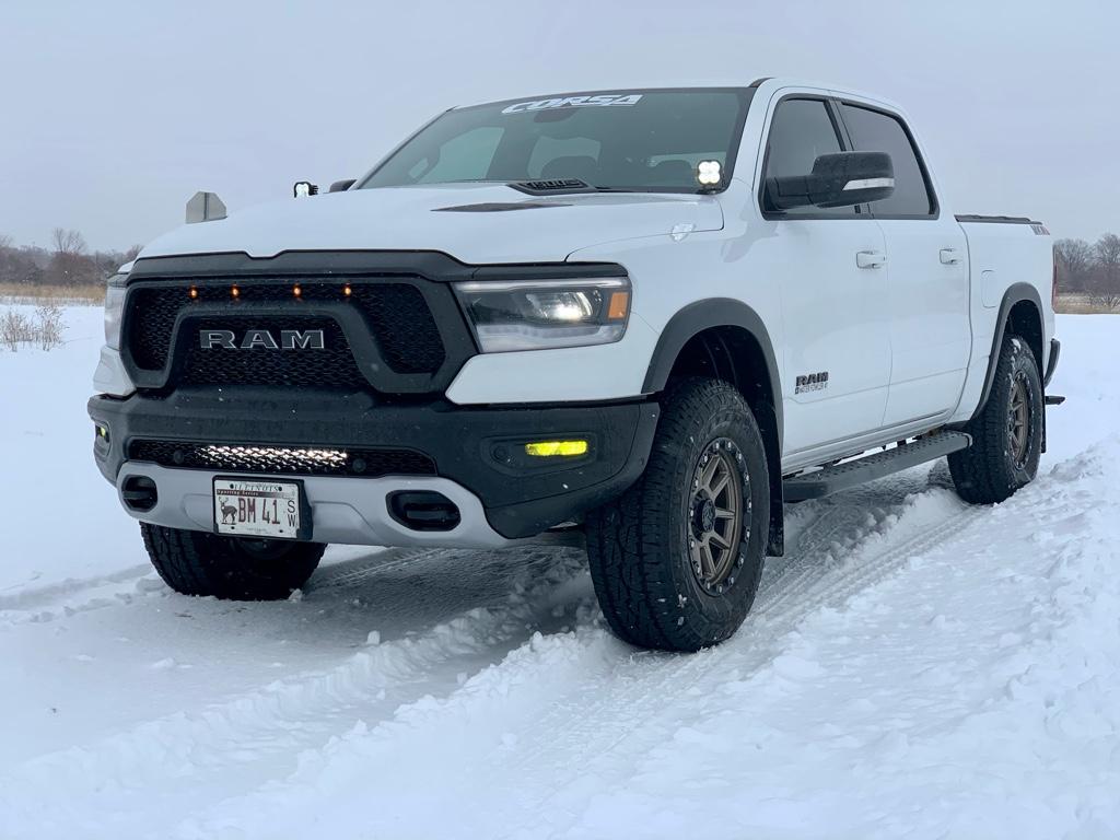

Here’s how she sits post Bilstein install.
