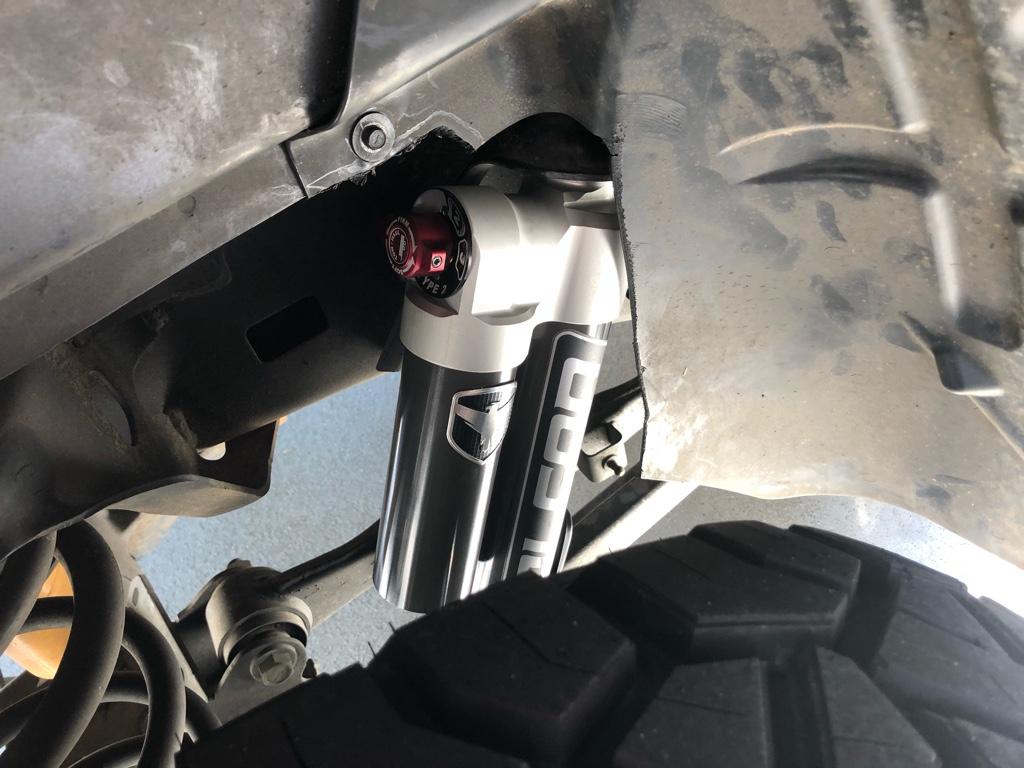

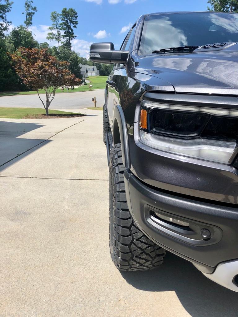

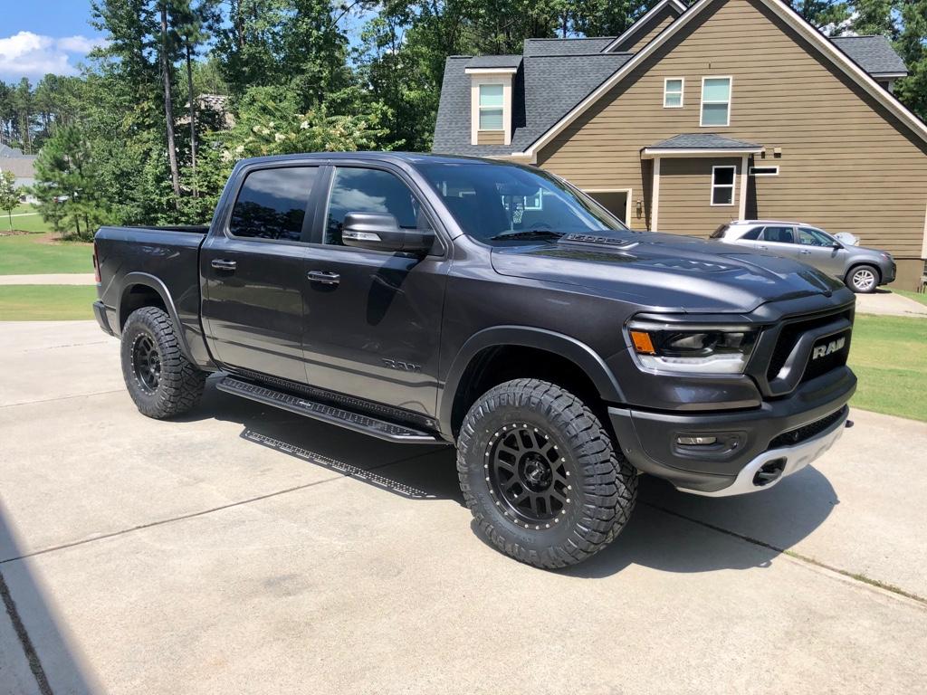

I just got my Falcon suspension installed today. So far, its exactly what I wanted. I did have to add a 1/2” Wulf top spacer up front (thanks for the heads up) to get perfectly level. The front end as measured from the tow point went up exactly 3” but, I also added 35/12.50r18 Nitto Ridge Grapplers. Like I said before though, the truck is perfectly level as measured by the lower punch weld under the doors.
On road feels tighter and more sporty. They might break in a bit more though. I took the truck on some rough gravel roads nearby and I was duly impressed. The ride was very smooth at about 45 mph.
Pics or it didn’t happen:
Did you also use an aftermarket UCA? What was the spacer brand you went with to get perfectly level? Also, did you go with larger tires afterwards? Sorry for all the questions.
No I did not. I called Falcon and asked them this question and they informed me that their shocks maintain the proper geometry.
