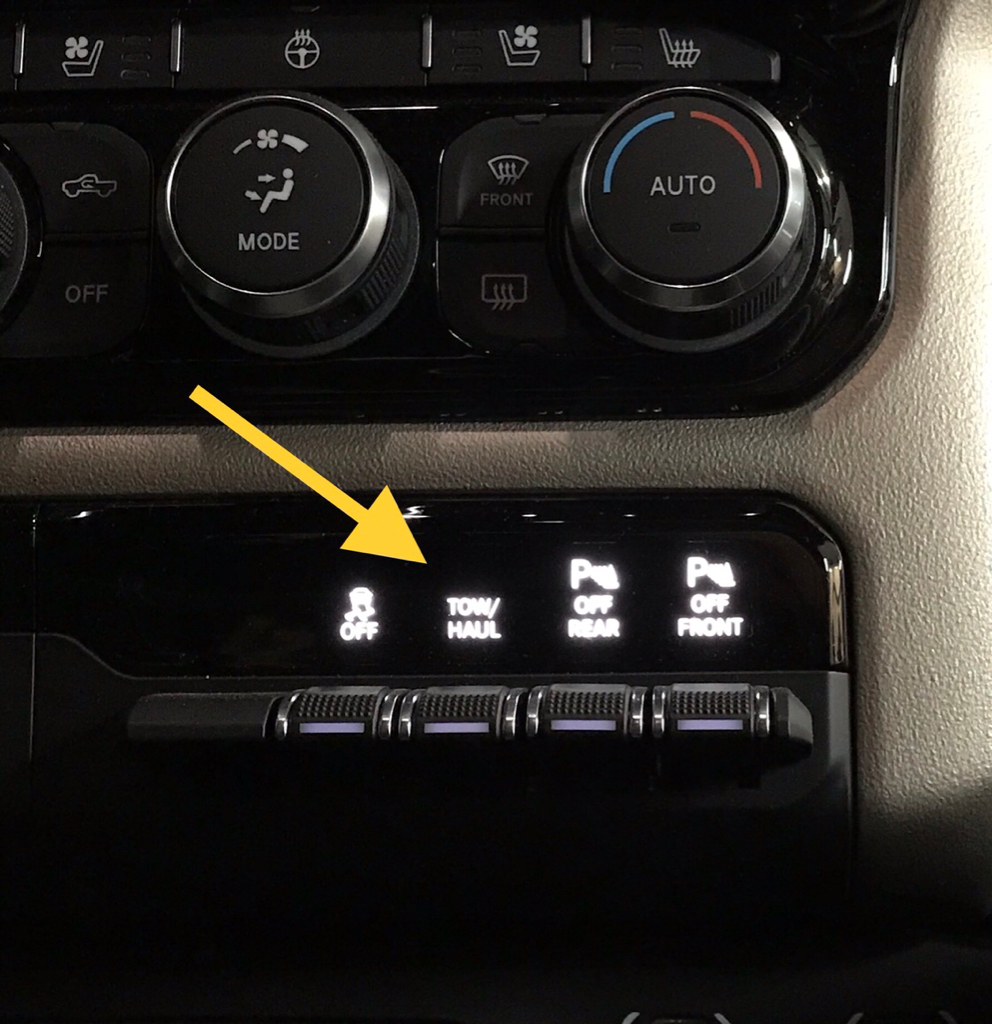

Continuing to exhibit my ignorance. Is the TH mode button on the turn signal stalk like other vehicles sometimes have?

According to the 2019 Owner’s Manual “When frequent transmission shift occurs (such as when operating the vehicle in hilly terrain [among several situations] select TOW/HUAL mode, or use the Electronic Range Select (ERS) shift control to select a lower gear range. “
“...using a lower gear range will improve performance and extent transmission life by reducing excessive shifting and heat buildup.”
I prefer to use TOW/HAUL in the hills for the added engine braking.
That’s a good point, and something I’ve done on previous vehicles.
