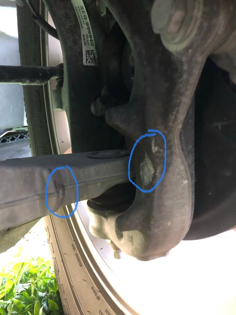

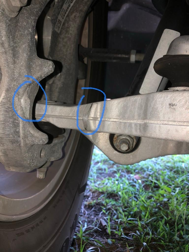

Sorry if this is the wrong forum but it seemed appropriate. I’m getting a rubbing noise and vibration that I can feel in the wheel and on the floor when turning the wheel at low speeds (5-10 mph). It usually happens when turning onto a street or into a driveway. I’ve looked at some posts from the past but there hasn’t been a clear cut answer. I took it to the dealership 3 times. Twice asked them to take a look at the suspension to make sure everything looks good, 3rd time I told them about the issue but they can’t replicate the problem. I took a quick peek and instantly noticed some rub marks on both sides.
I showed these to the technician and he said these are the bump stops and that it’s normal for them to rub. This looks like it would only hit on full lock but the rubbing happens while not even turning the wheel a full 360 degrees so I don’t know. I’m trying to fix the issue before I put on billsteins and a new wheel/tire combo because I don’t want them to blame it on that.

20200628_195524.jpg Mine has the same mars on the metal lol I thought it was just me and thought it was due to the leveling kit I have on. But anyways, that isn't your issue... have you tried jacking up your truck and spinning the wheel? How do your upper control arms look?

You’re experiencing two separate things. The marks are normal. They are the bump stops that you hit when fully turning. The rubbing At partial turn isn’t related to that at all. It’s likely contact with the mudflap at the rear of the front wheel well. There’s an article in the wheels and tire section - at the top in stickies. It may not be contact with the flap, but it’s not the bumpstop.
One thing I do is get my truck really dirty then look for the shiny spots from rubbing!

Yep, the point is that it ain’t the bump stops. It’s something else.
