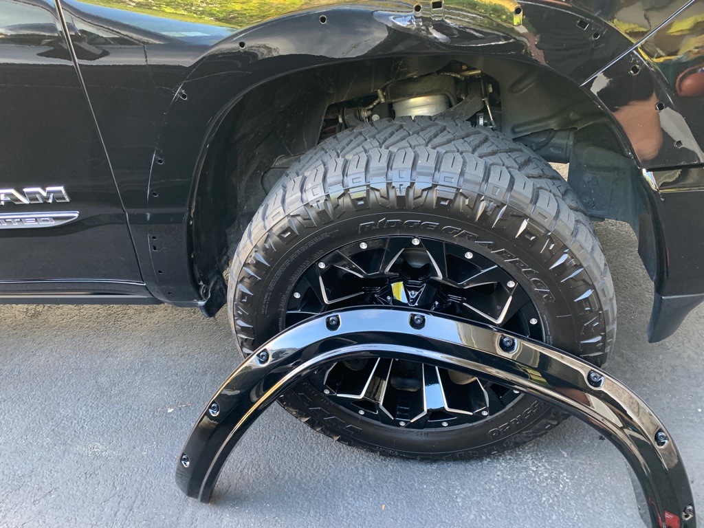

Can this be done? Are the only holes on the inside the fender?

Anyone found a work around with these? I'm thinking about removing them and putting a wrap to match the paint around the fender. I think the truck looks way better without them.

How do you remove the oem flares? Just taking out the screws doesn’t do it. I want to install larger Bushwacker flares.
There's white clips on the backside of the flares. You would need to remove the fender liners to get to the clips.
mike12193
Jan 10, 2019
139
96
If you remove the fender liners and put a 8mm or 9mm socket on the back of the fender where the clips go in you can take them out without and clips breaking. If you don’t care about the clips just use a trim removal tool and take your time. Pretty easy.
