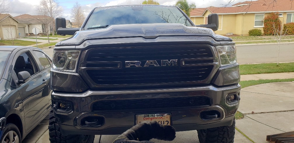

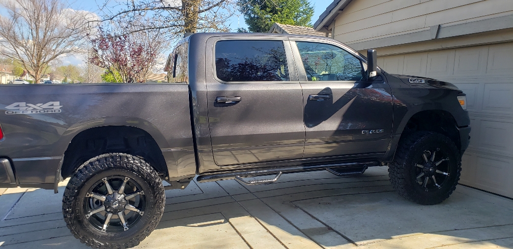

ciscokid
Mar 21, 2020
My 19' is lifted so ags or airdam isnt gonna do squat for mpgs.. plus i feel it runs hot compared to my old 07... if i go for it ill post pics cuz i cant find any on the webs
If anyones got a good reason not to do it enlighten me plz

I had the front 2 inch leveling kit installed in my truck. So I feel the same way. With the front end lifted 2 inches the air dam is only covering about 1/2 inch instep is 2.5”
How big is that lift along with wheels and tires? Or is your garage super short?
