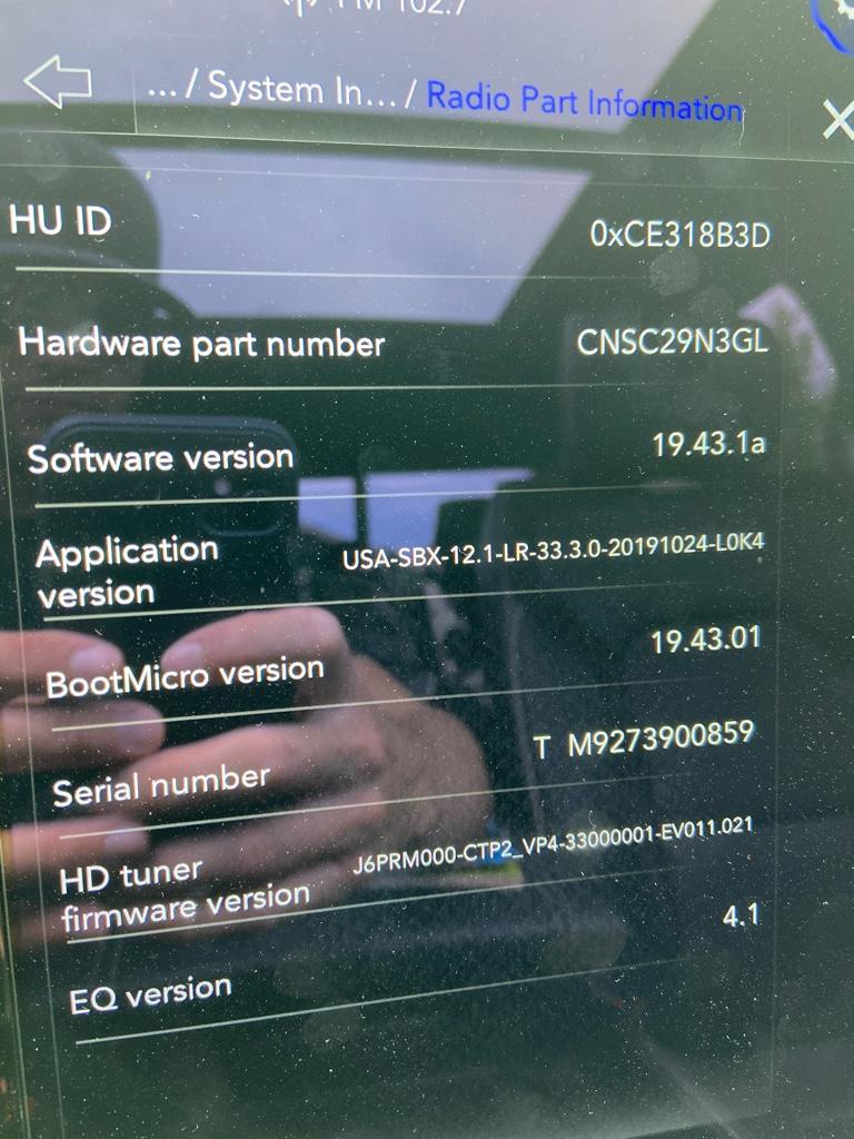

So I’m assuming I need an update? Do I have to go to the dealer for this or is this OTA? D5D31C3D-AA25-4E9D-AC5D-3ED132AC94C5.jpeg

I’m not sure my 12” Uconnect is on the latest software (2019 Limited), but when I logged in the website said I was, however the website acts like I have the smaller 8” screen.? Anyhow, it’s working to my satisfaction so I’m reluctant to have the dealer do anything to it. The GPS claims it’s up to date, but I find that hard to believe. I live on an island so admittedly it’s not a big deal, but to me I simply like things current.
