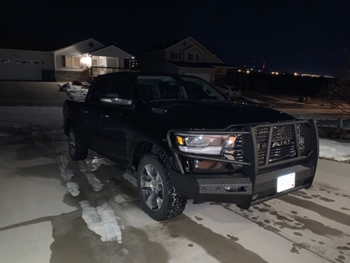

Here you go. A few things I noticed:
Ranch Hands instructions for disassembly BLOW. Use the instructions on Addictive Desert Designs.
You can get the two outer 18mm bumper bolts with a 1/2" drive ratchet and 12" extension. If you don't have an 18mm swivel ratcheting wrench or u joint, you can get the third bolt with an al18mm wrench and cheater bar by sticking your head arm in between the air dam and the inside of the frame rail.
The forward tow hook bolt is not 18mm. I think it may be a 20mm. I didn't have one, so I used Milwaukee max grip vise grips. No marring on the head due to the bolt you can twist with a screwdriver once locked down.
The nuts holding my air dam on were actually 13mm
The holes where the parking sensors go aren't exact. A few of them are slightly too large, making the supplied grommet not hold the sensor securely. I currently have them held in with duct tape, and that may be permanent.
Have a buddy help you. I didn't, and it was harder than it should have been. I'm pretty stout, and was able to lift the bumper up on some blocks to get it close and then manhandled it for the bolts. But a buddy to help lift and hand you various wrenches and sockets would make it go much faster.
The left-most parking sensor wire is just a tad short. I ended up taking the main bumper harness connector out of its mounting hole and zip tied it a little further forward.
All in all, it was pretty simple. But it is definitely time consuming.

Looks good! A shop is putting mine on because it’s replacing the factory after I hit a deer. Hopefully they do a good job. It’s getting line xed as well

Looks good. Glad to see some pictures of one. I hit a hog with 1800 miles on my Laramie Sport as well. I've ordered and am waiting for ranch hand to ship my body shop one that is just primed so that I can have it painted to match the rest of the truck.

I’ll have some pictures in the next week or so when mines gets out of the body shop.

Good idea on getting that Line-X'd - they hold up pretty well, but eventually they start to wear some paint off around edges and then rust...
CE Devine - looks excellent - nice work.

Here it is LineXed super happy with it.

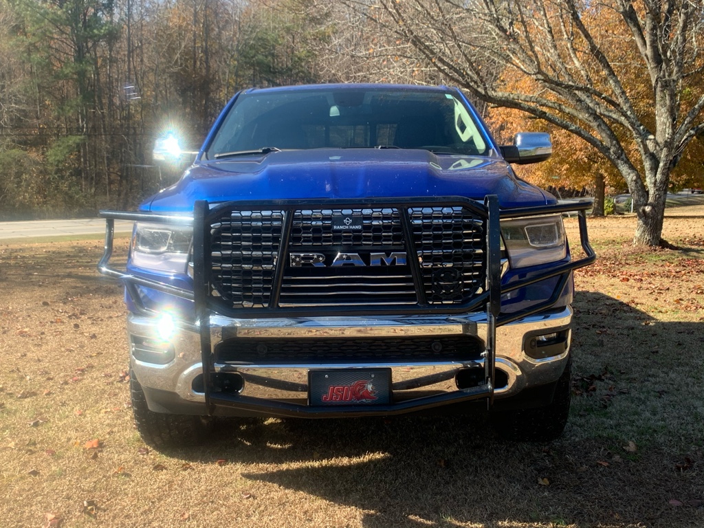

Does the grill guard come with the bumper? Sensors still work? I love the way it looks on your truck.
It’s all one piece. As for the sensors they are malfunctioning but I hit a deer and did a lot of damage so it is a result from that and the body shop not catching it because I had them off.

Dang that bumper looks good. I'm not sure it would look as good on my silver Laramie. If anyone has a picture, please post it.

I have the ranch hand grill guard on mine. It interfered with my front parking sensor though. It looks good and I like it though.
