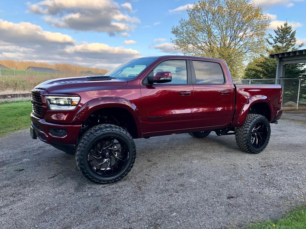

I’m running a 6in bds with 3:92 gears, 35x12:50-20 nitto trail grapplers-with 20x10 wheel. These 35s run very big to size, my wheel and tire set up weighs in at 119lbs. Driving the truck down the road you would never think you have that big of a tire under you. The gearing and transmission in these 5th gens are amazing. 1CE9481A-C794-45F7-A717-3C5955DF1CAE.jpeg

4CEFA693-8567-44C0-960B-5668E9BC5403.jpeg F8930CB7-4C81-4AFB-9C93-B00B10EC9B83.jpeg 6” RC with vertex coil overs on 35x12.50 grapps, rides better than stock.

Nice color match on the steps ….
Thank you they are the from rough country, they came black with a semi rough finish. After about two months they looked like sh$t so I had them painted for $100.00 per step, definitely way better painted.
